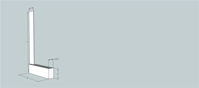

I found this amazingly useful gage block that has been in my shop (used on every project but never as a gage block) for many years.bcone1381 wrote:Making my own...that is kind of what I was thinking. The commercial blocks look like square stock bars. Is is common to make one with three known dimensions, like 1/4 x 3/4 x 2, then another with three more dimensions?
[ATTACH]18923[/ATTACH]
- Engineer's Square (Custom).png (20.58 KiB) Viewed 2230 times

NO, not really. I use Sketchup regularly but for very fundamental functions. Sketchup does an awful lot that just does not sink into this thick head. I am constantly relearning what it does.bcone1381 wrote:That is real world practicality, Dusty! You must be pretty handy with Sketchup!
