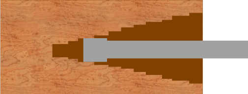

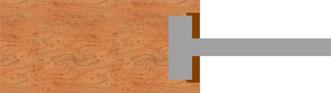

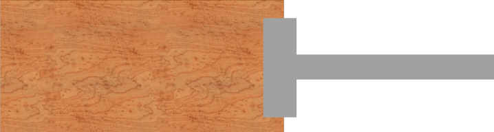

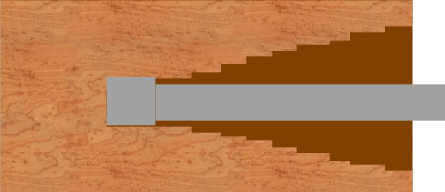

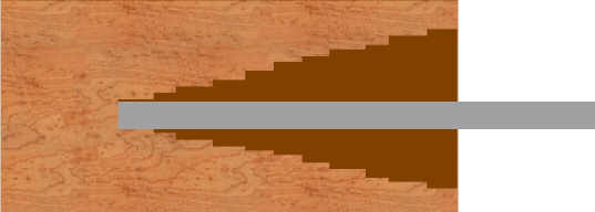

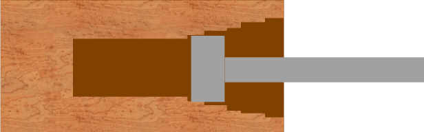

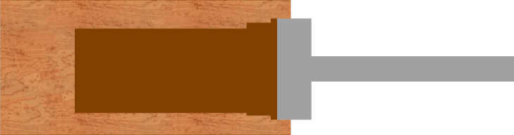

Hi,
I once attended a demo and the person showed using step drilling and claimed that it was the way to go to make deep holes in end grain. I personally have never tried it but for what it is worth I'll post what I remember of the idea.
You start with the finished hole size and pick that bit. You drill in just enough to provide an area of that hole size which will be used later to guide the bit. You next take the next drill size smaller (I think he was going in 1/8" steps) then do the same sort of thing, that is using the point of the first hole to do the second hole and again only as deep as need to guide the bit. He did this until he was down to a 1/4" twist drill.
I did a few sketches to show how this works so maybe you will want to take a look at them as we go. So far we have covered the first 3 sketches. Now you start coming back out drilling each hole to the size of the step and having the step you drilled earlier as a guide. See the forth and fifth sketch.
You work your way back to the hole size you want and you're done. It took a while with all the drill bit changes and clearing chips but it did work. Someone did ask about bit life and he said he got years out of his bits and had been doing this for some years.
Like I said I've never done it but he made it look easy. Any brave soles out there you might want to try this out I'd like to here back from you.
Since you allowed only 5 attached files see my next post for the remaining couple of sketches.
- drill 1.jpg (10.13 KiB) Viewed 12781 times
- drill 2.jpg (10.09 KiB) Viewed 12747 times
- drill 3.jpg (9.01 KiB) Viewed 12736 times
- drill 4.jpg (8.62 KiB) Viewed 12732 times
- drill 5.jpg (8.02 KiB) Viewed 12740 times
