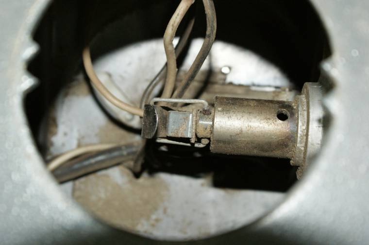

Hi SB and welcome to the forum,
My first guess is that the retaining loop that connects the speed control quadrant to the control sheave has come off the quadrant. This is mostly caused by a lack of lubrication in the past and/or a failure of the bearing in the end of control sheave. Remove the logo plate from the rear of the machine and have someone rotate the speed control handle while the machine is running. DO NOT PUT YOUR HAND IN THE HOLE WHILE DOING THIS!!! If the quadrant arm moves then all should be OK with the speed control.There is a retaining loop that connects the control sheave to the speed control quadrant.
WARNING!!! Do not put your hand in the inspection hole with the machine plugged in. Full line voltage is always present on the rear of the switch when the machine is plugged in.
Look at the photo.
[ATTACH]18982[/ATTACH]
The retaining loop is visible at the end of the control sheave.
NOTE!! The wiring is misplaced in this pic. The wires should be under a clip just behind the speed control.
Your problem CAN be fixed and I am sure others here will jump in to help.
One other word, "Don't make red sawdust" it is painful and difficult to clean up.
Look at the photo.
Bill V

The 'loop' is there to keep that 'button' from rotating, not to pull the control sheave.
When you set the speed to a 'high' setting, the control sheave opens up and the spring on the motor shaft should cause the floating sheave to move inward which results in a small diameter idler pulley and a larger diameter motor pulley.
When you then adjust the speed control to a slower speed setting, the control sheave is 'squeezing' the idler pulley and if the motor pulley does not open up, the belt will jam in the idler pulley.
A more likely condition is the speed control knob is slipping on the shaft. The outer speed dial would move towards slow, but the control sheave would not move.
Take the knob off and see if it has been slipping. The set screw should be tightened into a shallow hole in the shaft.
Since this condition will probably result in incorrect spreed indication on the dial, a high speed adjustment should be done.
Wish I had a simpler answer, but that's the way I see it. If doing a high speed adjustment is a 'mystery', get back and tell us and ye shall be pointed to it!

mgbbob wrote:When I purchased my 510 the previous owner said the clip had come off of the quad arm. He had the new parts. What I found out was the lower sheave was frozen. If yours changed speeds to start with then it can't be frozen but it might be reacting slowly.
I know there is a session on lubricating the lower sheave so you might try that. If I remember right you need to push in on the lower sheave to get to the oil hole. You will probably be able to feel if it is hanging up.
Since increasing speed requires less torque, the knob probably did not slip then.
Since this condition will probably result in incorrect speed indication on the dial, a high speed adjustment should be done.
Welcome to the forum!
