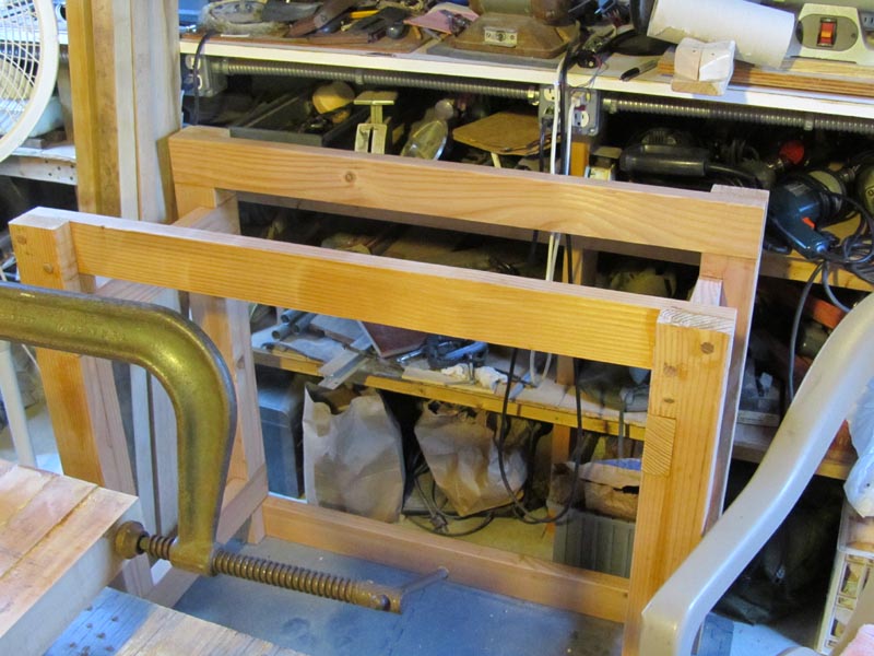

Well, I finanlly got my first ever workshop finished and working. now I'm building my first ever, woodworking work bench........
got the frame work for the top done and after I get it together, I'll start on the top. I plan to make it out of four layers of 1/2 inch MDF, topped with a tempered hardboard surface.

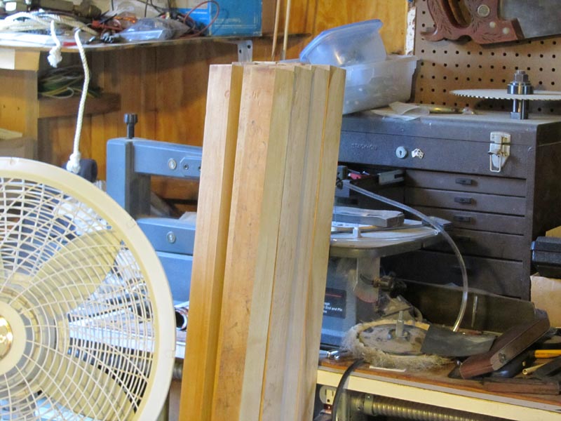

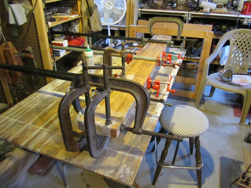

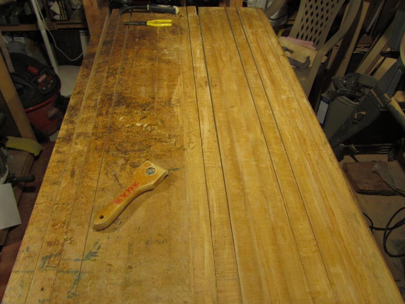

New update......got a couple of projects finished and got back on the bench. My in-law found, beside the road, an old school maple table top like we all used to work on. I delaminated all the boards except two that are still tightly bonded. scraped the old glue, top surface and started gluing them back together. got the frame put together and will plane sets of glued up boards before gluing all tighter.

The bench looks fantastic. I doubt that it will wobble on its legs at all (good and stable).
However, without cross braces immediately beneath the MDF top, I expect that you will have some sagging in the middle. MDF is quit stable but it will sag under its own weight if not supported.

I sure do thank all of ya'll for the comments! and yes Ed, I've always made things in "overkill" mode so I didn't have to worry about them.
I'm still pondering the bracing mentioned under the main top area?? a couple of cross pieces firmly attached or connected to the upper side rails?? and the overhang with the vice is also something i'm worried about......I almost considered ripping the main four layer top and installing some stringers like we used to put in the foam for our surfboards?? but still thinking??
any thoughts?? anything would be welcome.....
take care, bill
