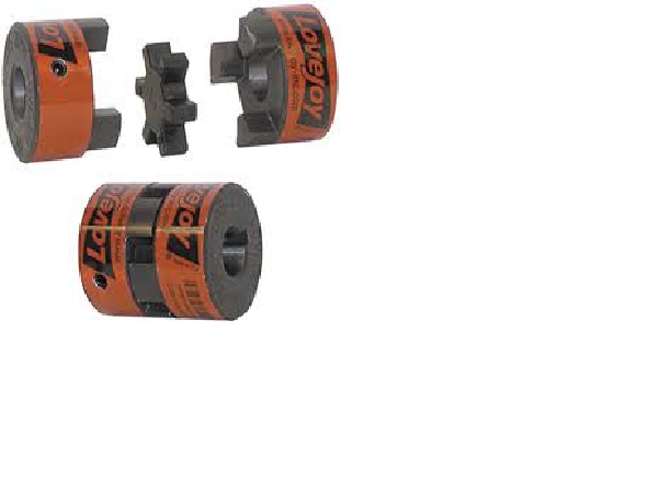

I have never had a problem with the SS plastic couplers, however I think I've seen somewhere (maybe on this forum) that the Lovejoy couplers work well... perhaps because they accept slight misalignment better, and can dampen out some of the vibrations (just me speculating). They run about $30.
[ATTACH]19088[/ATTACH]
- lovejoy coupler.png (88.01 KiB) Viewed 2655 times

And they be 'shorter'!
A attribute appreciated by 'mini' folks.
