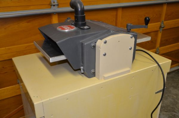

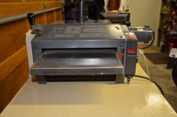

This evening I'm off to check out a ShopSmith planer. Is there anything I should lookout for, it looks to be the MkV mount model that has been mounted on a cabinet.

That looks like a really nice planer. A new set of knives alone costs about $100 so that is a great deal. Run the thickness adjustment all the way up and down to make sure the table mounting posts are not bent. You could take a look at the knives to see if there are any bad nicks. I would also look at the drive pulley to see if the key has fallen out and marred the shaft or pulley. Good luck.

That looks really clean and an excellent price. Since it is a Mark V mount planer mounted on the stand, I would ask if they still have the brackets for locking it onto the Mark V. You also would like the knife setting jig and manual.
Interesting dust collection attachment....looks like the one that mounts to the table insert for shaping/sanding. The most expensive replacement parts are the feed motor and controller, so make sure that it feeds the wood at various speeds.
Look at the infeed roller to see if it is the steel serrated roller. If not you can plan on purchasing the upgrade in the future. You may also want to get the planer dust chute if there is not one as it will offer improved chip collection.

Wow - great deal. I humorously watched one come up on E-Bay yesterday (just planer - no table) with a starting bid of $20 and a BIN price of $450...within an hour two people bidding against each other had run it up to $350 (mind you, an item with a 6+ day listing period and within one hour they took it from $20 to $350)...finally one of the people said screw it and paid the BIN price. I'm not sure I'd pay $450 for a used SS Planer period, at least not without exploring my other options first, and I certainly wouldn't do it for a planer I can't even inspect and try first. Now $150...I'd be all over that.
With the price the speed controllers and feed motors are going on EBay these days, I don't think you can lose for that price. It's a nice machine and the power feeder is a great feature. Setting the blades after sharpening out the nicks was a pain for me, probably not for others. But it can be a big money saver. For a price less than a cheap lunch box planner, you've got a nice machine. Looks well taken care and the setup looks like they gave it some thought.

It seems to be in great shape, table cranked all the way up and down, motor runs great (came with a 1 hp motor), it has the knurled steel infeed roller and the rubber out feed roller is in perfect shape. It also came with the manual, the knife setting gauge and the mounting clamps. The knives need sharpening but I could not feel any big nicks.
