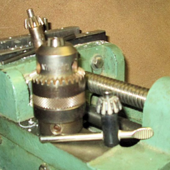

I have the same Cushman chuck (not as shiny as Todds) and the key seen in the foreground fits both the Cushman and the SS one on my drillpress............unfortunately there is nothing written on the key to identify it. The key in back has teeth that seem to fit but the "nub" is a bit too long for correct engagement. Sorry I cannot be more helpful.
[ATTACH]19064[/ATTACH]
- IMG_0676.JPG (69.78 KiB) Viewed 5446 times
Peter
