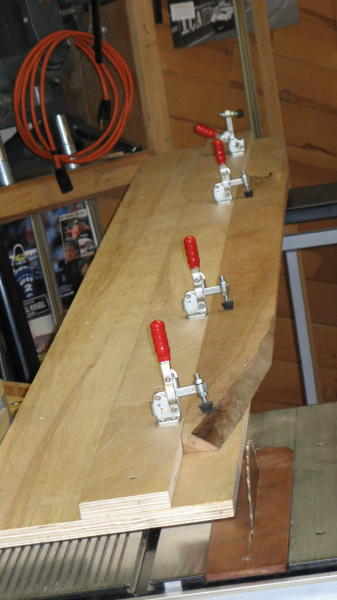

Another approach is to use a 'carrier' board. Here's a pic of one I used some years ago. I've since re-made it using T-trac and hold downs.
[ATTACH]19101[/ATTACH]
[ATTACH]19102[/ATTACH]
[ATTACH]19103[/ATTACH]
