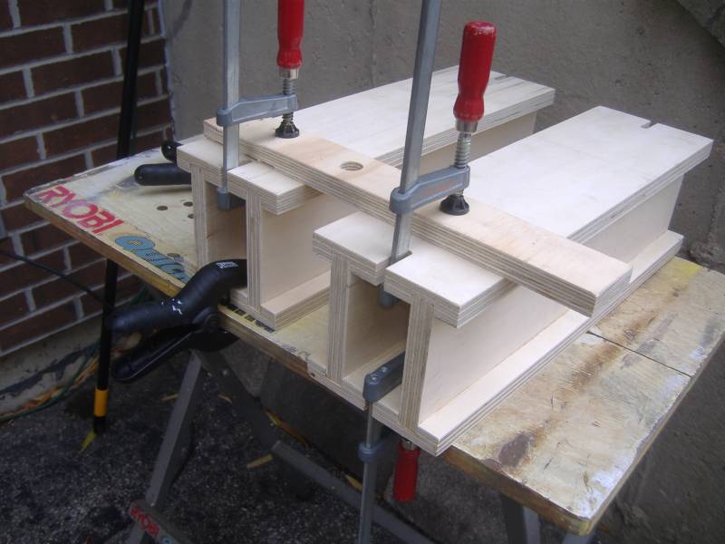

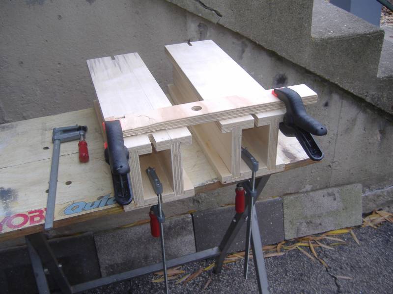

Some times it is nice to have "other" ways to clamp things and that is what this pair of units do. So you can see what I writing about I'll add a picture right here.
[ATTACH]19161[/ATTACH]
[ATTACH]19162[/ATTACH]
They are not finished yet but I plan to use them this way for now and then as I gain some experience with them I will/might add some more slots/holes to give more clamping options.
Construction wise these are easy to make. Tops and bottoms are cut to size then dado's are cut, cut one way flip and cut second slot. The vertical members are cut to size and then everything is glued up. The end slots were done on the powerpro in router below mode.
I plan to use them on the table shown, my black and decker workmate, and on the shopsmith.

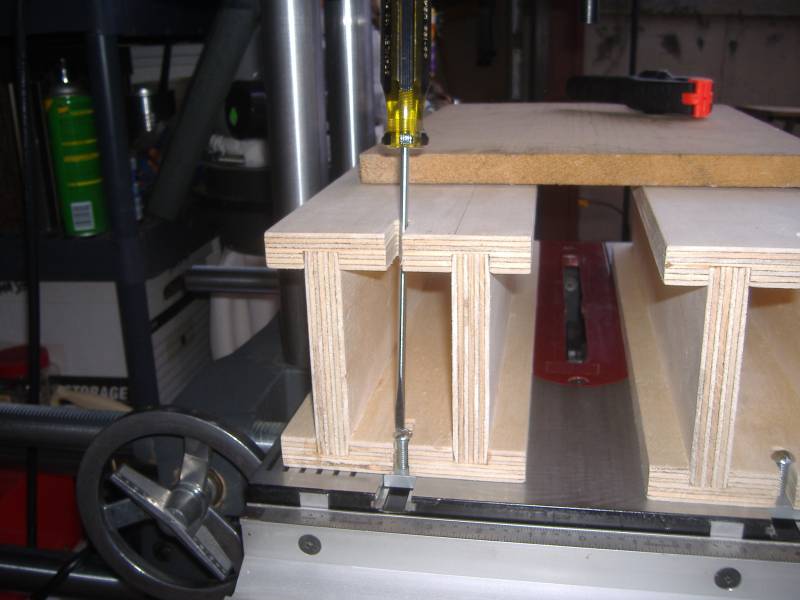

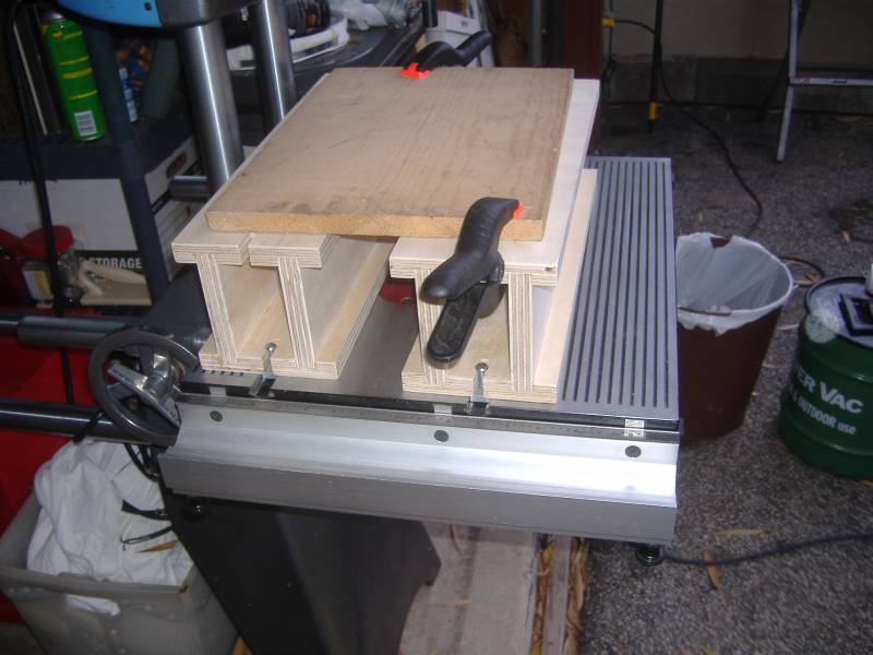

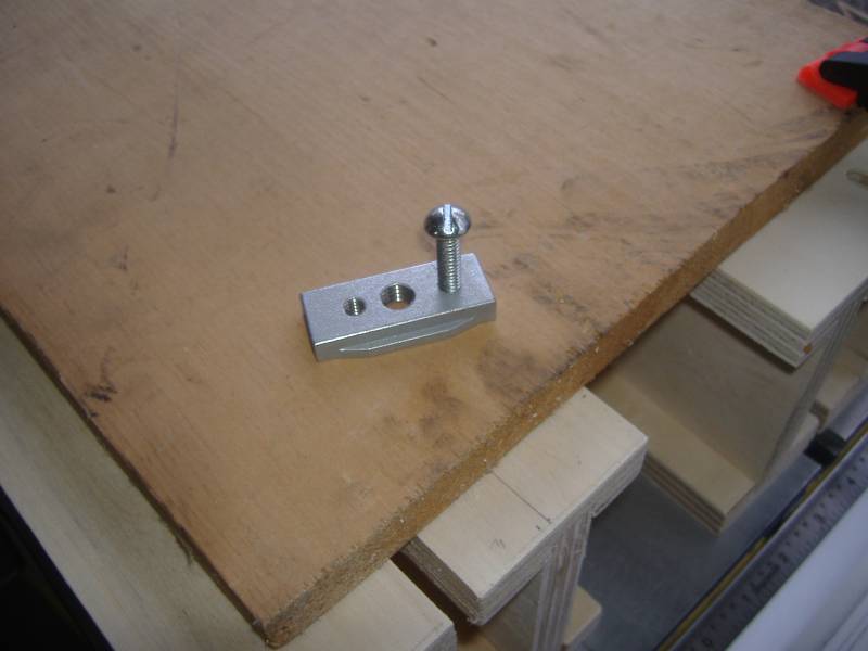

While these clamping helper can just be used on the main table the tables with t-slots have an added advantage of being able to be clamped as shown. The use of external clamping will work but I did not post anything showing that. If that is a problem for you let me know and I'll see what I can do.
[ATTACH]19163[/ATTACH]
Note the use of the slot for tightening the fastener with a screw driver.
[ATTACH]19164[/ATTACH]
A work piece or sacrificial board can be clamped down using any number of clamp types. C-clamps would be another good option.

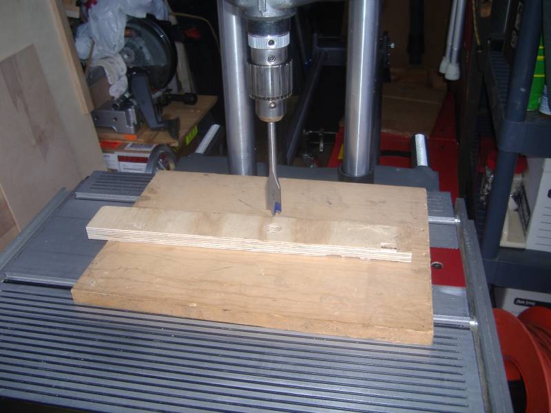

First we set the scene, you have just set up to do some drilling in the vertical position. You are using some long spade bits for the drilling.
[ATTACH]19166[/ATTACH]

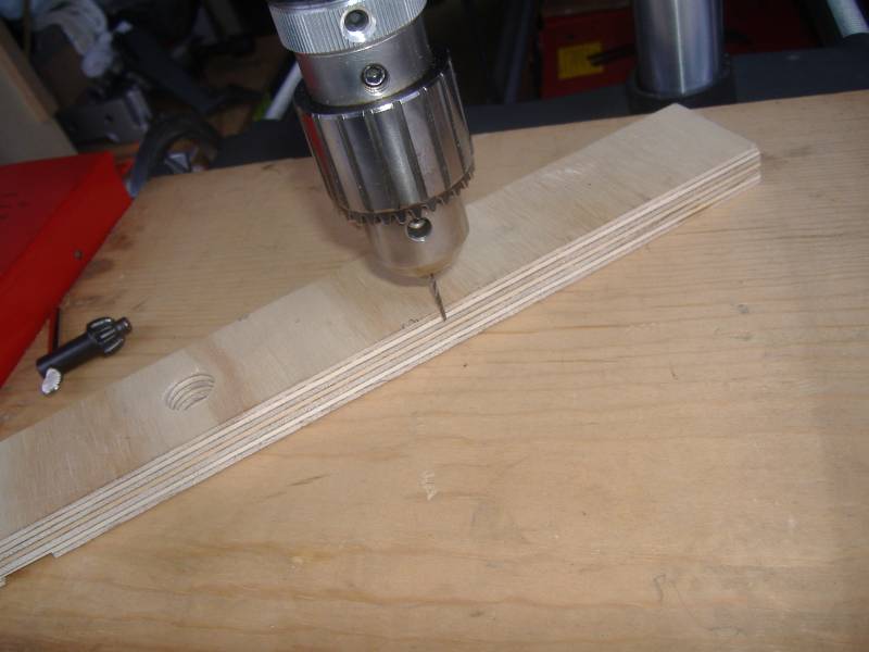

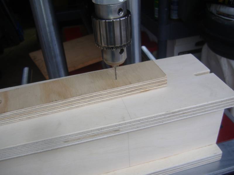

You have almost finished all of the holes when you BIL stops over. He needs these 1/16" hole drilled through a piece of plywood. He likes to talk your head off and right now you need to get some work done, and then there was the football game where his team walked all over yours. Time to get him out of here!
You get the bit, you loosen the depth stop
[ATTACH]19167[/ATTACH]
OH no the table and headstock are too far apart to do the drilling! You really don't want to move the headstock or the table, they are just right for the operation you are doing. But he has just recapped the first scoring drive of his team and is about to start the second scoring drive....
You have to think fast! Oh yes those new clamping helpers! You grab one and put it on the table. Yes it is going to work! You flip the switch and start drilling his holes. Now you wish you had your old noise shopsmith, he can just keep talking now..... darn powerpro!
[ATTACH]19168[/ATTACH]
OK he still stays another half hour but at least you only have to reset the depth stop and you can get back to work. No drilling required, no connecting and disconnecting and the table and head stock never had to move.
