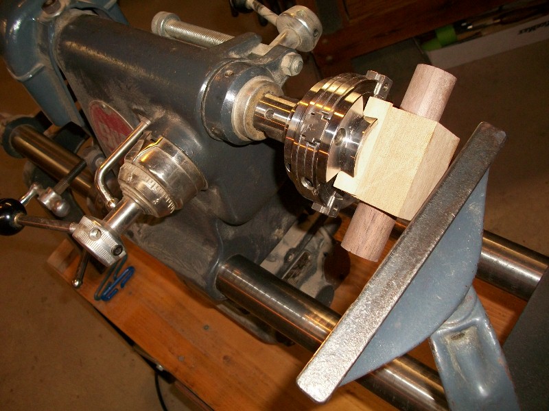

The starting blank is a maple block 1 3/4" square & a couple inches long, center bored lengthwise, with a 1" walnut dowel glued into it.
[ATTACH]19178[/ATTACH]

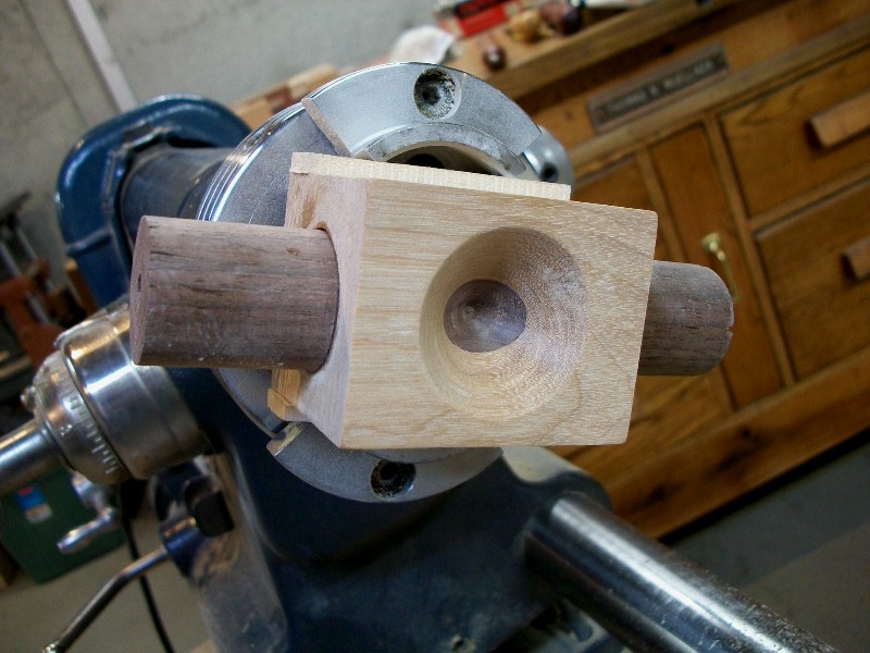

This ornament involves 2 separate turning steps. The first step is to turn cone indents into each of the faces. (and sand each face to finished smoothness before rotating the block to do the next face. You must do the sanding during this phase) I used a Nova midi chuck to hold the piece for this phase.
[ATTACH]19177[/ATTACH]

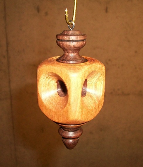

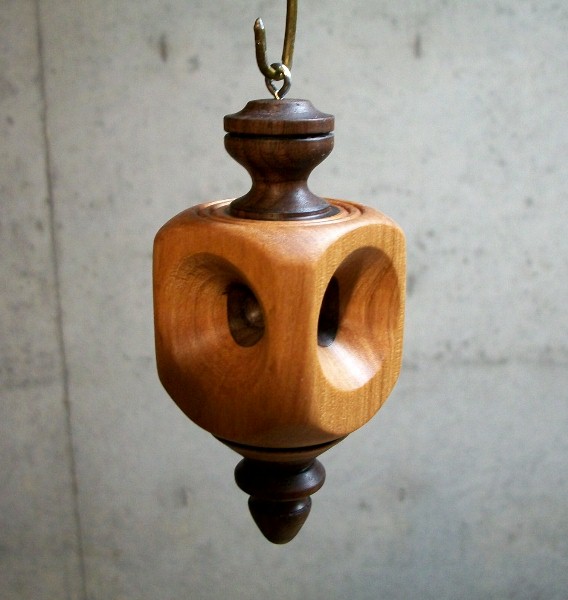

After all 4 faces of the block are done, you remove the chuck & use the standard spur center & tail center & mount the dowel lengthwise on them to finish the ornament. You can just make this out of one block & stain the ends, but I liked the 2 tone effect from using a contrasting dowel better.
[ATTACH]19179[/ATTACH]
[ATTACH]19180[/ATTACH]

Regarding the speed, maybe it's just a comfort thing...I'm not sure. Here's what I do know. I'm in a lathe turning group in town that has some very talented turners. I've mostly observed & learned from them to this point, because a couple of them bring "show & tell" pieces that are better than many I've seen at fancy gift shops. A little intimidating, but awesome.dgale wrote:Very nice - well done! So had you been able to resolve your MK5 tool rest problem, do you still think you couldn't do this on the MK5 due to not being able to reduce the speed enough?
However, I was amazed that at all the demos they've done at meetings, except for sanding, they turn at very low speeds. Not just to round off the piece, but all the way through.
Without a speed reducer, I can't get there on the Mk5, but my 10er with the speedchanger, in the low range and at the lowest speed, get's me there.
As to the tool rest, it seems that no matter how tight I crank the wingie-dingie (not a technical term) I get movement. Granted, I haven't done lathe work on the Mk5 before & maybe I missed something, but the 10er's tightening method seems to work better.
If anyone out there uses the fancy universal tool rest, please chime in on your experience. While that looks like just the ticket, it's not in my budget right now. Same for the speed reducer, but I guess it doesn't matter as long as the 10er is here. Also, I like the extra weight of it in general...not when moving it around but when turning on it. (and, of course, it's hard not to love a machine that your dad helped you turn your first project on)

This was my first use of the chuck. I bought it a while back but never used it. I tried using a face plate but screw placement to avoid holes in the finished ornament was an issue. (probably wouldn't be if I used a single long block to start)reible wrote:Nice job Tom!
I really like how the project turned out plus it was nice to see how you did it.
I've just recently did some turning using the chuck with just two jaws, I wasn't too sure how that was going to work out but it did fine. I left some extra material at the clamping area but I like you you added some scraps to protect the project, going to have to do that from now on.
Going to have to get my 10er done next summer, didn't get anything done on it this year other then move some parts around... now I have to hope I can find them all again.
One of my brothers, up farther from you is getting snow, anything in your area?
I wasn't sure removing 2 jaws was going to be okay, but it worked fine.
