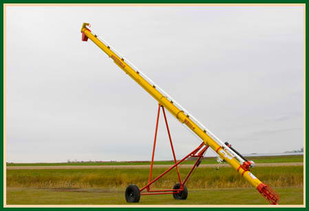

I was really preferring to run it out overhead since it would be easier and also easier to access if a problem occurred later. Then it hit me I have a 6" X 36' strong smooth steel tube that is strong enough to only need support at maybe 2 or 3 points even with a heavy ice load. I have an older transport auger (grain auger) that I can use the tube from for this.
It looks like this one:
[ATTACH]19232[/ATTACH]
This is probably the route I will take... Time will tell.
