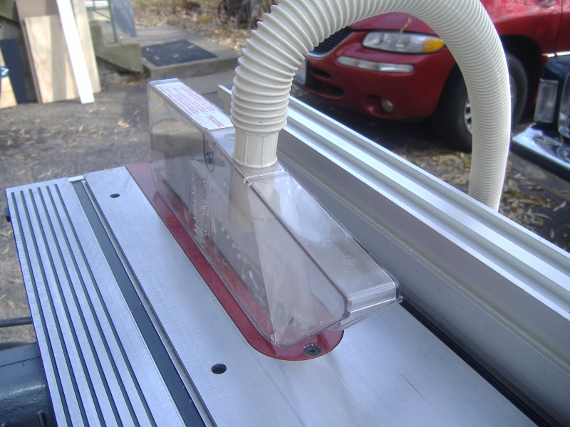

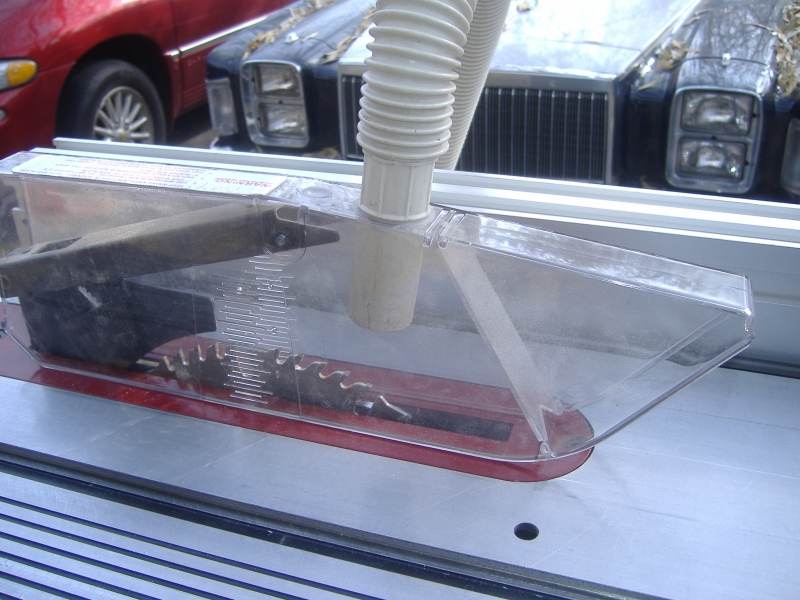

I purchase an upper guard off ebay then used a saw hole to make a place to mount a hose. I added a cap to use when a hose was not in place... it is amazing how much saw dust will come out of that hole without it!
I wasn't using it today but stuck it on so I could post a couple of pictures. The hose is not the one I normally use but it was out so I just stuck it in place.
[ATTACH]19240[/ATTACH]
[ATTACH]19241[/ATTACH]
I find that this works pretty well but since I have only this and nothing to compare with. I do find that it is hard to position the hose at times. If I were inside I could attach it to a ceiling but outside I would need a sky hook.

All I did was drill a hole and attach a vacuum fitting to the top of the Shopsmith upper saw guard. Works fine but I don't like the hose being there atop the table. If I had an overhead collection system, it would be fine.
