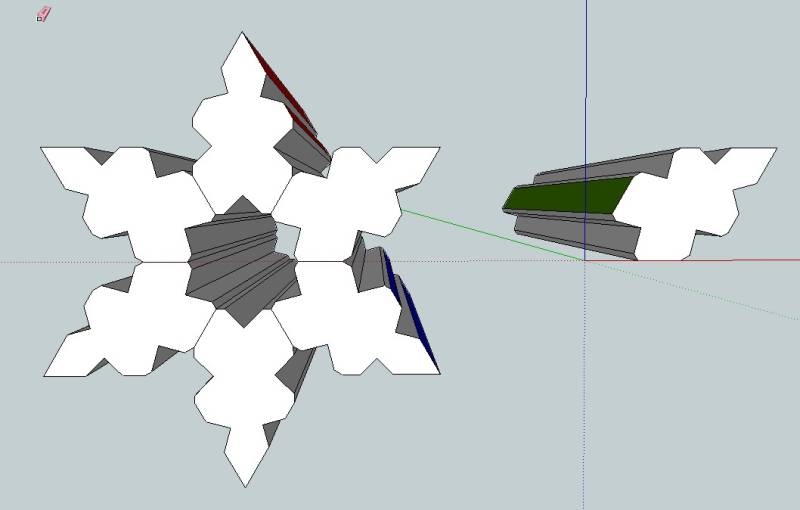

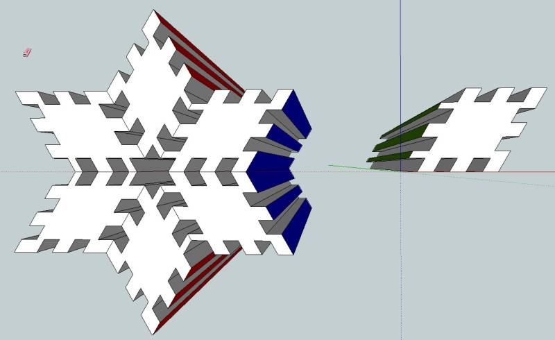

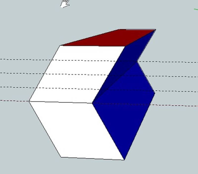

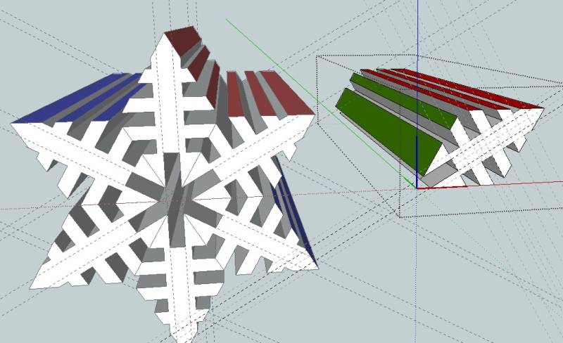

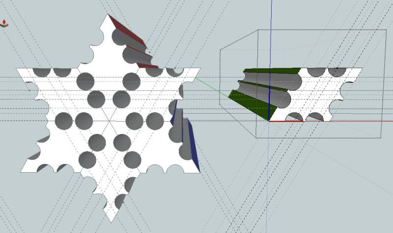

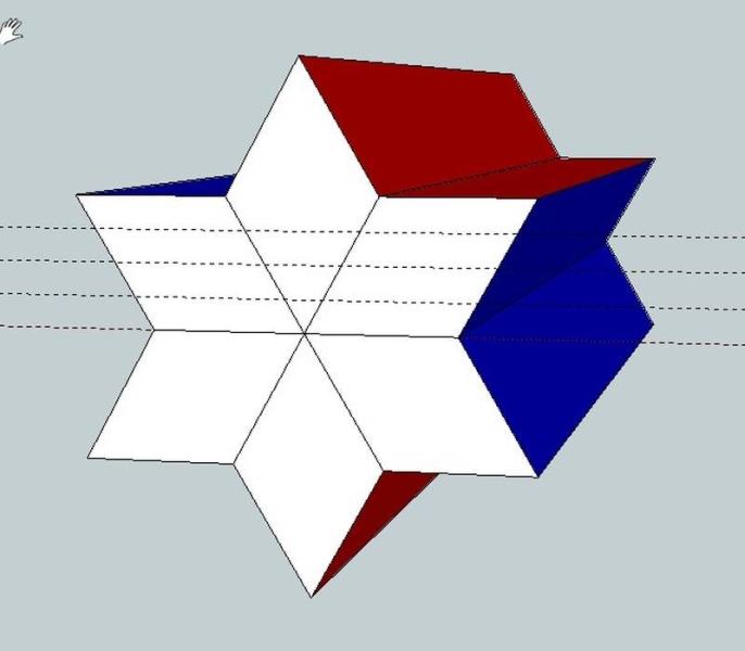

But wait, there is sketch up. Not only does it make it easy to see how they go together it also lets you test designs.
Step one make a sample piece.
[ATTACH]19398[/ATTACH]
Take two parts and put them together
[ATTACH]19399[/ATTACH]
Check your fit
[ATTACH]19400[/ATTACH]
Since the first part is a component each time you use it, it remains that part. So anything you do to the single part is reflected on both the two parts (first glue up) and on the final glue up as well.
[ATTACH]19401[/ATTACH]
Just a couple more in the next post.
ScreenHunter_14 Dec. 08 09.31sc.jpg (106.81 KiB) Viewed 1704 times
ScreenHunter_15 Dec. 08 09.31sc.jpg (80.76 KiB) Viewed 1705 times
ScreenHunter_16 Dec. 08 09.32sc.jpg (87.98 KiB) Viewed 1703 times
ScreenHunter_17 Dec. 08 09.48sc.jpg (65.04 KiB) Viewed 1708 times

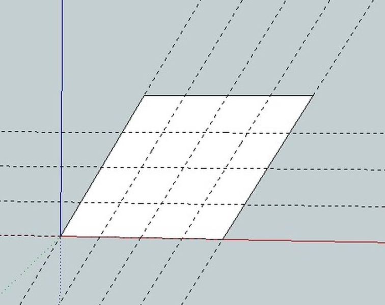

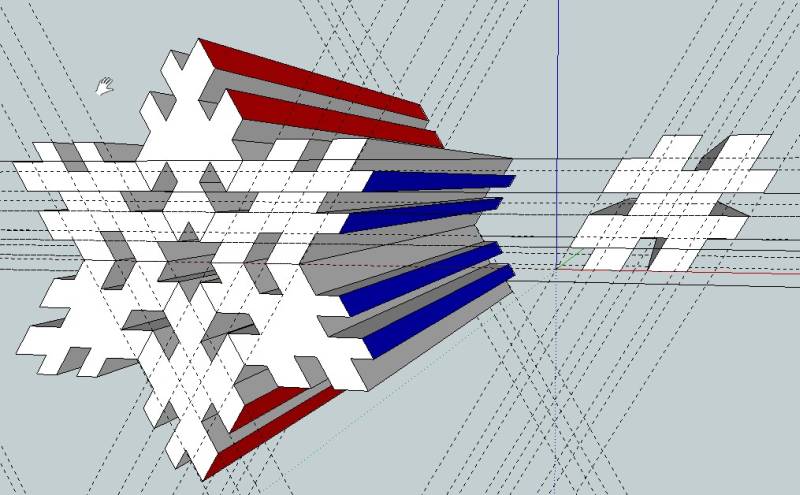

The rest I did today.
[ATTACH]19403[/ATTACH]
[ATTACH]19404[/ATTACH]
[ATTACH]19405[/ATTACH]
[ATTACH]19406[/ATTACH]
Not as useful as real ones but you could certainly do your planning this way. For fun you could also drill holes to add yet another look, or use different router bits....
ScreenHunter_19 Dec. 08 10.56sc.jpg (41.76 KiB) Viewed 1702 times
ScreenHunter_20 Dec. 08 12.18sc.jpg (22.89 KiB) Viewed 1702 times
