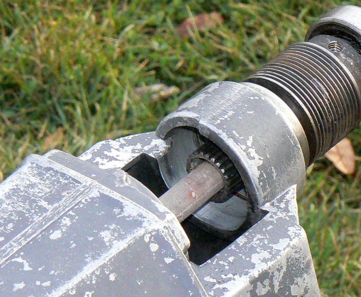

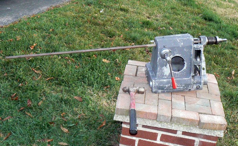

Not a 10ER, but the idea is the same.(thanks again Bill)
[ATTACH]19268[/ATTACH]
[ATTACH]19269[/ATTACH]
You only need two, but this is the site.

- main shaft removal.jpg (162.64 KiB) Viewed 4718 times
- main shaft remival 2.jpg (130.88 KiB) Viewed 4716 times

Thanks JPG,
Ordered bearings and now understand driving with bar principle.
Need to locate those set screws tonight, guess they are buried under a layer of paint. I assume they will be on the sides at 9:00 and 3:00 o'clock.

I just remembered, the "10" quill bore is a 'through', not a blind hole like the MVII/M5/V. The skinny rod will not work! A big fat dowel would though!fredsheldon wrote:ah, 90 degrees in first reply, not 180I think I have it now. Thanks for all the assistance.
Start by tapping and gradually increase force till it starts to move.
