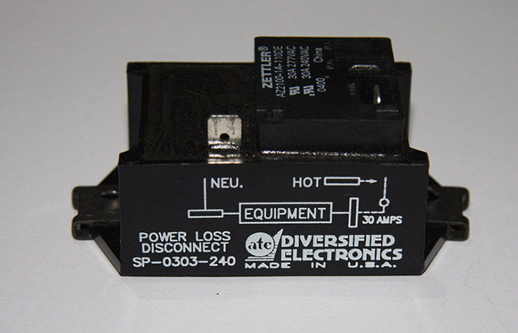

I have a Shopsmith MkV 510. Nothing happens when I switch on. I have found the fault is the power loss disconnect unit. The switch and motor are fine if I bypass this unit. The UK replacement price is HUGE and way out of proportion to what is in it. Does anyone know if I can subsititute it with a no volt release starter found on most UK woodworking machines ? ( green button start/red button stop and won't restart on its own if the power fails and then returns ) It would be a fraction of the cost I have been quoted and probably does the same job as the faulty unit.

I would like to see the faulty unit.
Curious where it is attached to the SS.
Image of Power loss disconnect unit
This is an image of the unit - I hope
- power loss disconnect.jpg (3.82 KiB) Viewed 9512 times
larger image
I have re posted the image in a larger size to show more detail
This is what it looks like
- power loss disconnect larger image.jpg (85.95 KiB) Viewed 9638 times
Typically, yes.ash wrote:Thanks for the advice, do I gather this is not usually fitted. If so does the wiring run from the switch directly to the motor/capacitor?
Is it possible it was added by a po rather than ss?
Connect the wires that went to the two right hand end terminals.
Tape off the wire that went to the left end terminal.
A pix would be helpful.
Is the purpose of this device to prevent power from being reapplied automatically after a primary power loss.
If that is its purpose, it is not "needed" UNLESS the Mark V has been somehow rewired to meet local (UK) code requirements.
