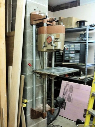

Here is a Mark 5 mounted to a wall:
[ATTACH]19423[/ATTACH]

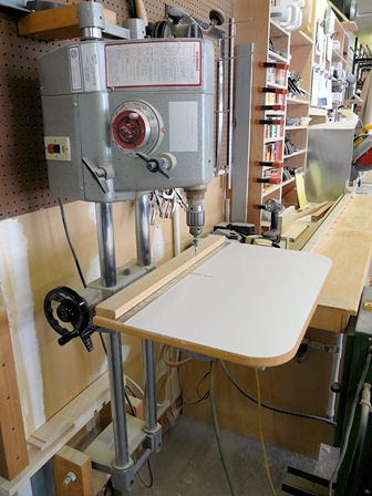

and a clone:
[ATTACH]19424[/ATTACH]
and a clone:
