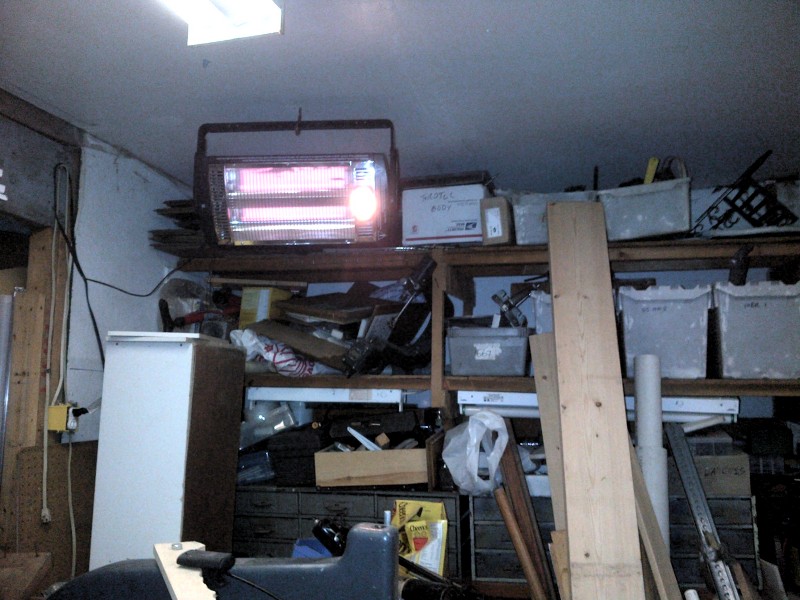

I have been using an electric radiant heater that I got from Lee Valley. It takes the chill off and lets me work in comfort. The climate here on the coast is a bit milder than where you are.
[ATTACH]19438[/ATTACH]
- heater.jpg (121.92 KiB) Viewed 3812 times
