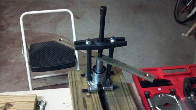

This is my first attempt to use a bearing press and just want to verify that my method is acceptable. I used a bearing remover/separator from Harbor Freight to press the drive shaft assembly bearings on my new 10ER. I used the table fence rail as a centering guide to keep things level and flat. Is this the proper method of pressing bearing on a shaft using this tool?

fredsheldon wrote:This is my first attempt to use a bearing press and just want to verify that my method is acceptable. I used a bearing remover/separator from Harbor Freight to press the drive shaft assembly bearings on my new 10ER. I used the table fence rail as a centering guide to keep things level and flat. Is this the proper method of pressing bearing on a shaft using this tool?
[ATTACH]19472[/ATTACH]
The 10 drive shaft is extra complicated due to no center dimple on the shaft(quill bore all the way through).
Your use of a piece of bar stock(table rail) is good, but I would reverse it so the 'outside counter sink holes' are not dinged by the screw.
It would be better if the two spacers were parallel to the shaft(they are a bit wide at the top bar).
I believe the flat side of the bearing do-hicky(the split silver colored part) is against the bearing.
I assume you are installing one bearing at a time from opposite ends.(do not forget the spacer the second time!).
Lastly, make sure the bearing gets started square to the shaft.
P.S. Make sure the bearing 'do-hicky' does not scrape against the shaft(open it up slightly to create clearance).

Thanks for the suggestions. There is a point on the drive side of the turn screw which fits perfectly in the dimple of the bar which holds it in alignment which is why I have it positioned as I do. I will adjust the tie bars to be more parallel to the shaft. Both bearings need to be installed from the same side, there is a flange at one end of the shaft that prevents installation from that end. I'll give it a try tonight and see how it works out.
