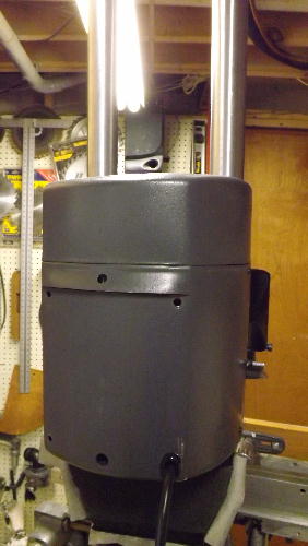

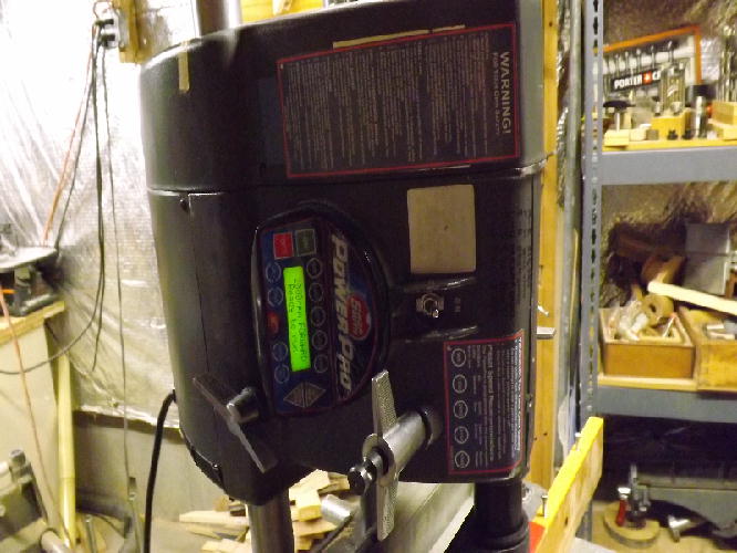

I recently added the power pro upgrade to my shopsmith mark 5 model 500. I do like the upgrade. However I did have one problem during routing operations at around 9000 RPM the motor controller gave me a high temp warning after about an hour of operation. Long and short of it I called shopsmith customer service and was told this in normal just shut unit off and allow to cool. Well to me this should not be normal and I made the following fix to prevent this from happening again.
1 The reason this happens is that the whole system just circulates the air inside the head-stock (no exchange of cool air, engineers must have though conduction though the head-stock body was good enough) and the air eventually heats up even in my cool basement of 65F.

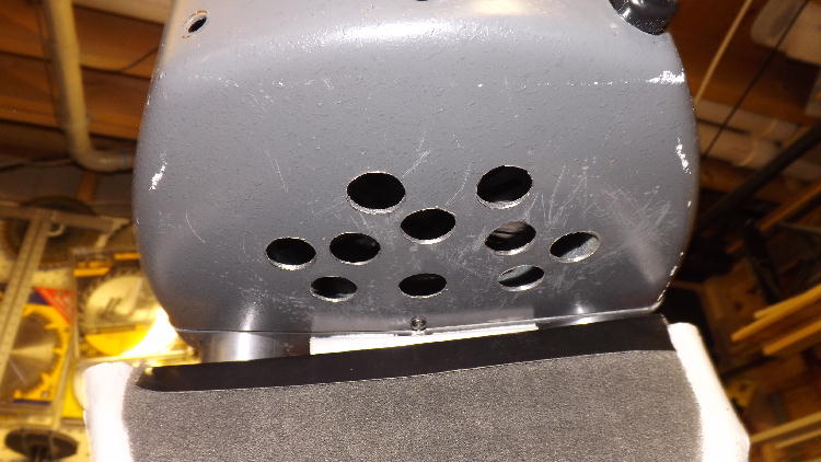

2. To fix this, the new motor has a very good fan that moves allot of air when operating, so I glued a 1 inch dense foam ring (7 inch outside dia and 6 inch inside dia) to the bottom of motor (this will fit up and seal to the back of the motor cover.
3. Made 8, 3/4 inch dia hole in the motor cover where the ring above mounts to the cover, this allows fresh air to enter the motor and blow the air inside the head-stock exiting out the idler plate, quill shaft auxiliary tool attachment ,logo plate after modification below and the vent on the bottom of the motor cover.
4. To prevent sawdust from entering the holes in the cover, put air conditioning air filter material over the holes (this can be vacuumed to keep clean)

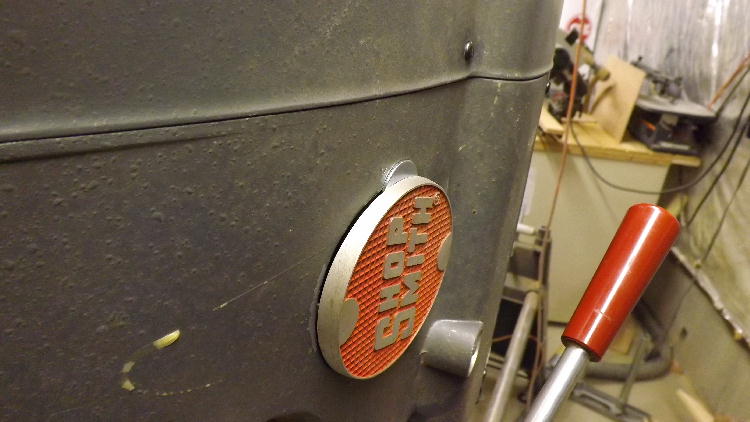

5. To allow some air up and around the motor controller, place two 3/32 inch thick washers on the two prongs (1/4" dia) on the back of the removable SHOPSMITH logo and replace, the gap between the logo plate and head-stock created allows the air flow but keeps the logo in-place.
Ran the unit for 2 hours at 10,000 RPM with no problems and now even the belt area on the top of the head-stock stays cool.
