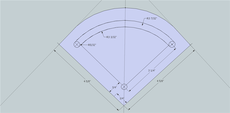

After posting the above, I got to thinking about this. It could be easier that we might imagine.
First you must have a sacrificial table on your drill press, clamped tight so that it won't move.
Then a 4 5/8" square piece of hardwood 3/4" thick.
Drill a small screw hole in one corner (3/4" from the sides). This will act as a pivot point for now but will get drilled out to a 1/4 through hole before we are done.
Locate the pivot point on the sacrificial table. It should be 3 1/4" from the drill line. Using a small screw, attach the trunnion to the sacrificial table at that point. This is a critical point. Get it right to match your trunnion (Miter Master).
Using a sharp, 1/4 brad point or forstner bit, begin drilling holes as you pivot the trunnion. Done carefully, a little bit of hand sanding and filing should finish the project.
[ATTACH]19626[/ATTACH]
WARNING: Double check the dimensions against your Tenon Master. I do not know that all Tenon Masters are the same.

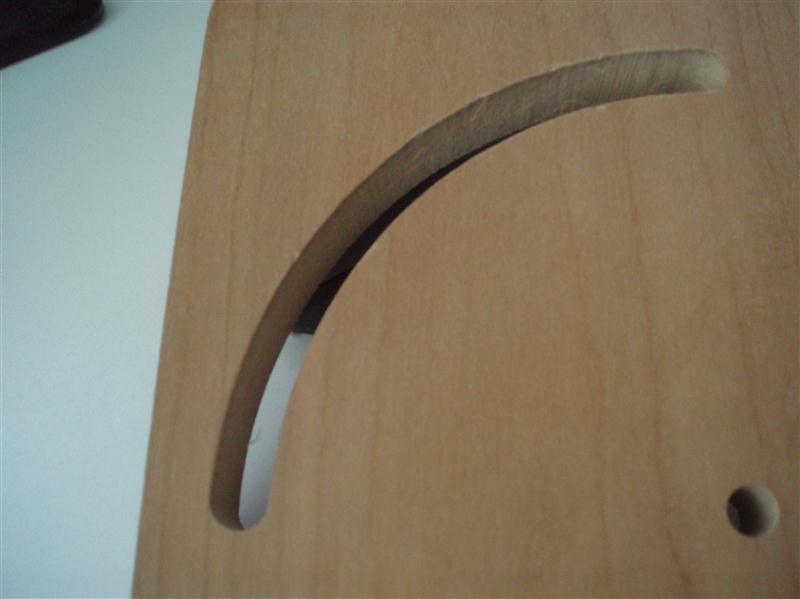

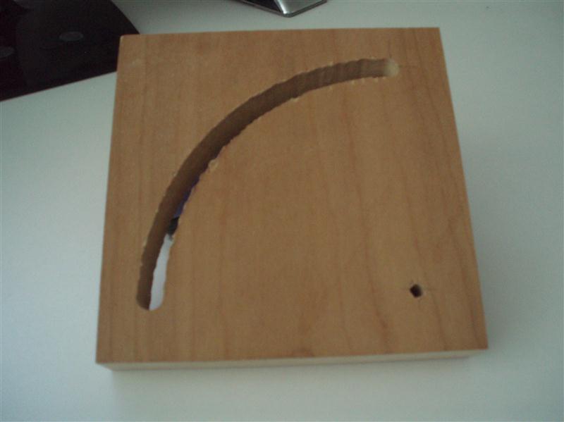

Is this an application where a router bit could be used safely in the drill press mode after all of the holes had been predrilled.
Because of speed limitations, I have never used my Shopsmith as a router but this seems like a place where that could be done.
I don't have a 1/4" router bit so I cannot test that idea. I did, however, do a sorta proof run using a 1/4" brade point and I think the results are a "go".
You tell me.
[ATTACH]19588[/ATTACH]
The pivot hole needs to be enlarged. The one corner needs to be rounded off. The routed slot needed to be dressed out. The process will work.
I was to close to not go one step further. I chucked a router bit that I do have to verify that this would work on the Shopsmith. The setup was not as cool as it would be with a router but it worked. I had a lot of chatter but maybe that is the result of incorrect speed for the router bit.
I'd send this to you david but it would do you no good. The arc is 1/8" offset from where it should be. Like I said, double check the measurements if you are going to do this.
