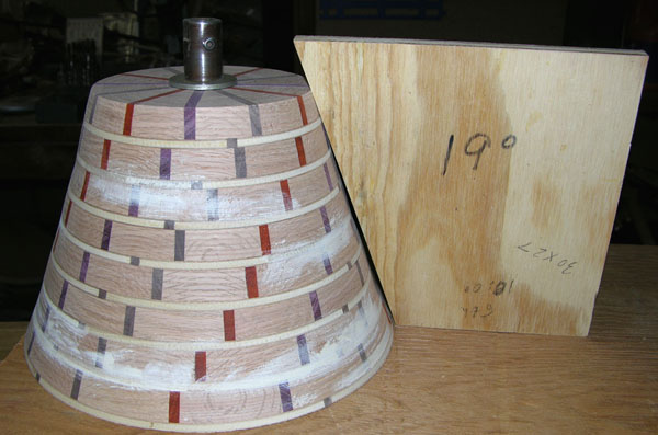

Post by robertw »
One way I glue up my stack of rings are, cut yourself a angled piece of plywood 6x6" with the same angle as you cut your rings at. Place this angled board alongside the stack on at least 4 sides around the stack. This will keep your angle the same so they aligned correctly for gluing.
