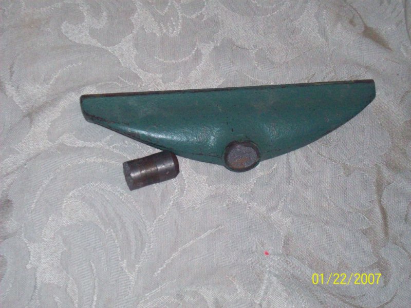

I was working on a piece of wood on the lathe, and my tool rest snapped off! :mad: :( I don't know what happened. I looked at the stud, and there is a little bit of a dark spot, so I don't know if it had gotten a bit of rust on it or something, or what happened.

Wow - post a photo if you can, it's hard for me to visualize how that could even happen.

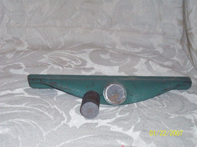

Here are a few pictures.
I don't know how it happened, but it did.

Wow! Flaw in the casting, perhaps? I don't see anything in the break that would indicate that but I can't imagine how else a shaft like that would shear in two. Fortunately these are fairly abundant for cheap on the used market.

The discoloration in the photos appears to be rust/oxidation. If that is the case, then post had some flaws or was cracked for a while.

Rob, I saw that too. So do you think it was just bad timing that it went the way it did? i have been using it alot recently, so I am guessing that it was using it so much recently that put the extra strain on it and it finally gave out?

I do not know about bad timing......but if it was cracked, then it was probably just a matter of time before it failed.
