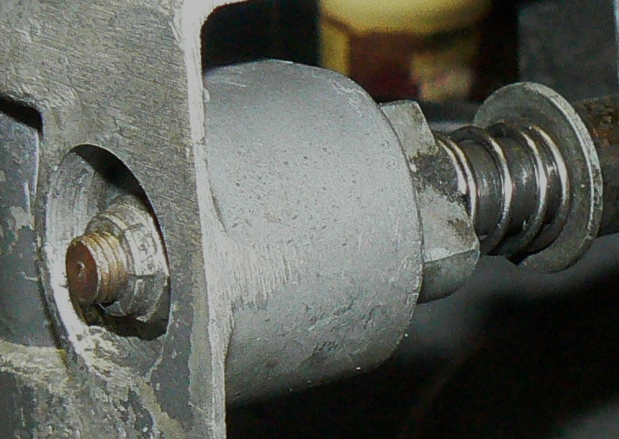

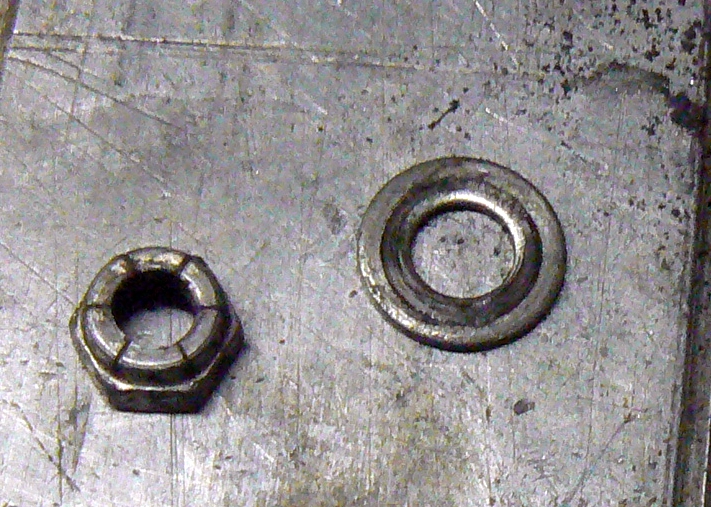

Since the shaft has a compressed spring, the first stop is to remove the nut on the end of the shaft.
[ATTACH]19519[/ATTACH]
The nut is a 'castle' nut that can be adjusted for wedge wear, but does not require a jam nut. A washer is under the nut.

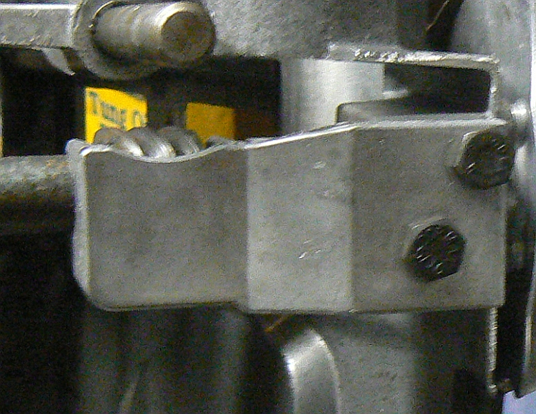

This bracket retains the worm gear. The worm gear rotating rotates a counter shaft that has a spur gear that engages a gear rack on the front way tube.
[ATTACH]19521[/ATTACH]

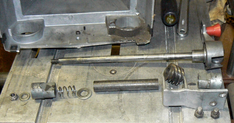

All the parts in order.
[ATTACH]19523[/ATTACH]

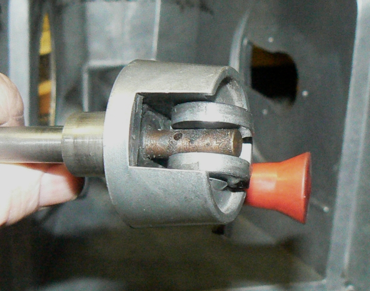

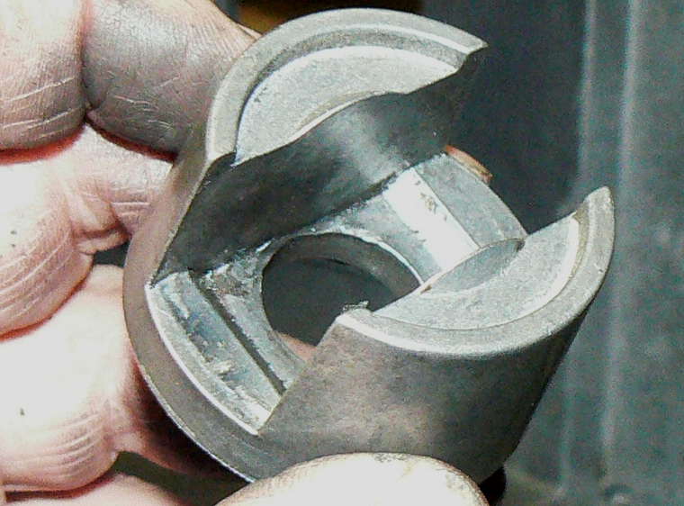

Now a puzzle. How to get to the pivot of the knob to the shaft.
[ATTACH]19524[/ATTACH]
This has a small ding that was preventing it being removed from the shaft.

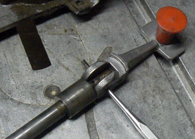

[ATTACH]19525[/ATTACH]

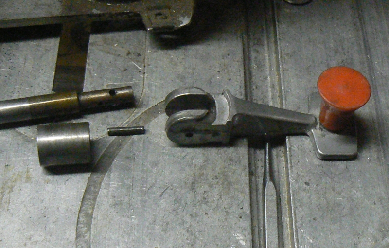

The pivot is a tension pin that is driven out.

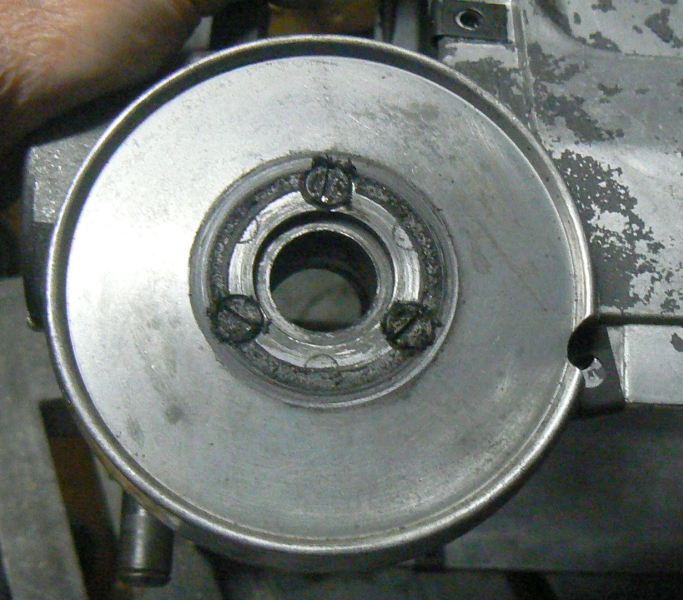

Last three screws remove the shaft cover.
[ATTACH]19528[/ATTACH]
