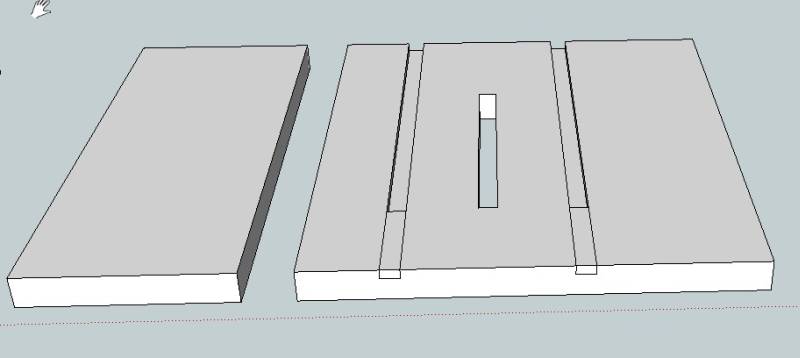

Tooooo cold in the shop to show how to do this on the shopsmith so I went and did the operation in sketch up. I hope this works out for you.
The intent is to show how easy it is to get a pair of runners dadoed into the bottom of a cross cut sled. I'm going to cover how to set and cut them so they fit.
You will need to have made some runners and have enought to cut off a few short pieces, say two 4"-6" long runners that we will use as part of a jig. You will also need a piece of 3/4" MDF or plywood about 4 or 6 inches deep and as long as the front of sled is going to be. A few pieces of scrap to make sure you get the dado width set correctly is also a good idea.
The main table and a floating table to the left will work. The dado blade needs to be adjusted to cut to a width for a snug fit with the runners that you have. I will assume that the runners fit the main table they way you want them to.
[ATTACH]19562[/ATTACH]
The actual location of the floating table will depend on the size of the base of your sled and where you want the center of the sled. You will need to decide these things before you go on.

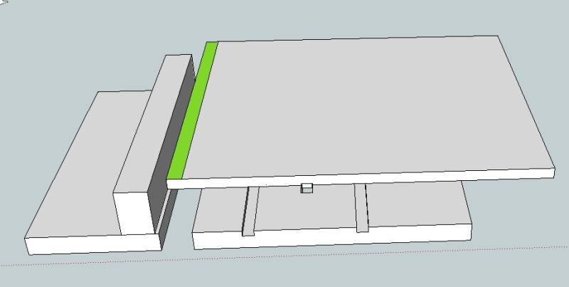

The short runners can be placed in the miter slots. If they are a bit short, ie not flush with the main table top you can add a couple of dimes in the slot then set the runners on them to gain height.
[ATTACH]19563[/ATTACH]

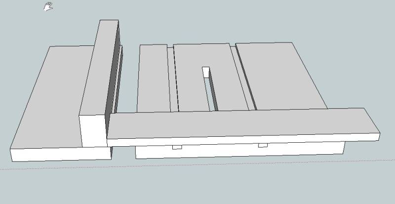

This next step uses the cut off that is the width of the sled you are making. Once you have decided where the center of the sled is you will add the rip fence that far away. The cut off then is placed square against the fence and the runners are attached to it. Nail, screws, double sided tape, about any way you can think of will work but they have to be fixed in place. This is critical, they must not be able to be moved.
[ATTACH]19564[/ATTACH]
You now have established the runner so they fit your table. Do a test slide, if it jams then you need a redo.
Mark the piece so you know which side was against the fence. You need to reference that end later.

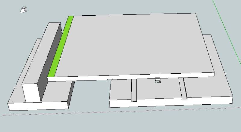

Without moving the fence you will now be making the first cut in the sled bottom. The depth of cut will be your decision.
You should mark the edge of the bottom that goes against the fence. Then make the first cut.
[ATTACH]19566[/ATTACH]

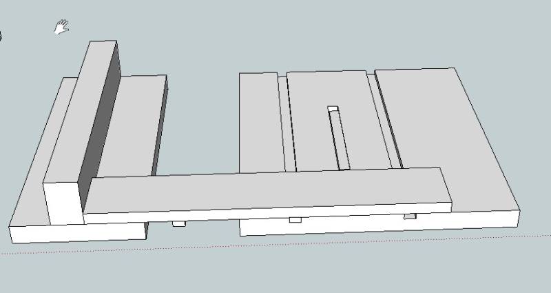

Next you will need to reposition the fence and maybe the floating table as well. That distance is measured by using the jig we made moments ago. This time the jig is place with the marked edge towards the fence and the right runner in the left main table slot.
[ATTACH]19567[/ATTACH]
The fence is adjusted square to the jig end and touching.
Now you can do the second cut, make sure you have the reference mark towards the fence.
[ATTACH]19568[/ATTACH]

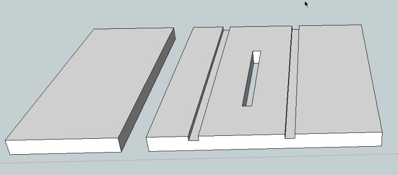

If everything went well you can now put the full length runners in the main table and set the cross cut table on. Everything should fit together.
[ATTACH]19569[/ATTACH]
If you want to test this out you can make a small crosscut table first or test it on some scrap...
