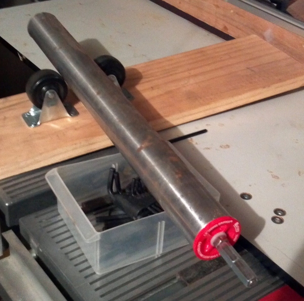

Some people here have used a plumbers plug to do the same thing. They also have used skate board wheels to hold the free end of the tube

[ATTACH]19594[/ATTACH]
I used a pipe plug from Lowes and two caster wheels screwed to a board to turn my tubes on my 520. I also used freeze plug replacements from Auto Zone.
