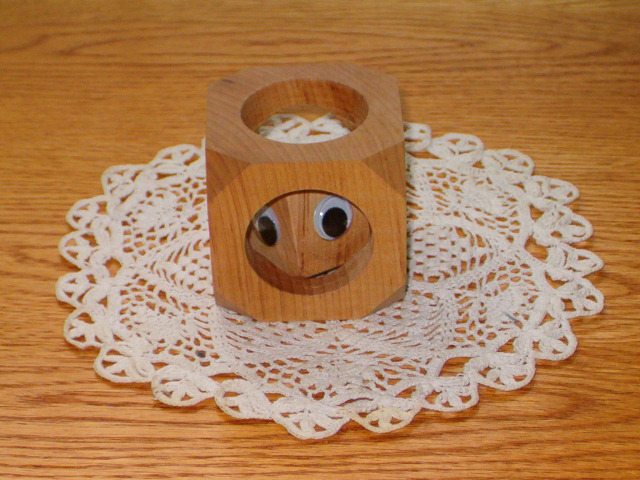

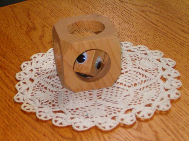

Here is my I box. Heck! I can't even take it apart! Let alone mount it to my Mark V.
[ATTACH]19629[/ATTACH]
[ATTACH]19630[/ATTACH]

Now, that is down right cute, Charles. :D
charlese wrote:Here is my I box. Heck! I can't even take it apart! Let alone mount it to my Mark V.
Gene
That is cute. How about another thread telling us how you made it.
Joe
Being a VETERAN is an honor
Being a GRANDPA is priceless

Looks like the chain my father made, out of a single piece of wood, during a camp-out one week-end. (Well, doesn't LOOK like it, but it reminded me of that chain.)
Dad did all the drilling, with a hot poker, and carved it with his pocket knife. I did one, later, on my first ER.
steve
