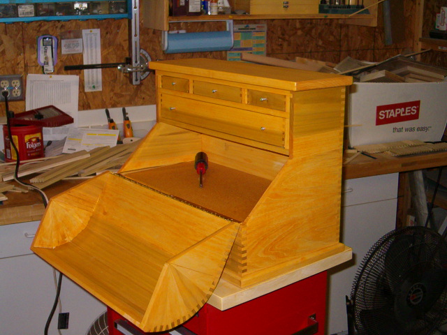

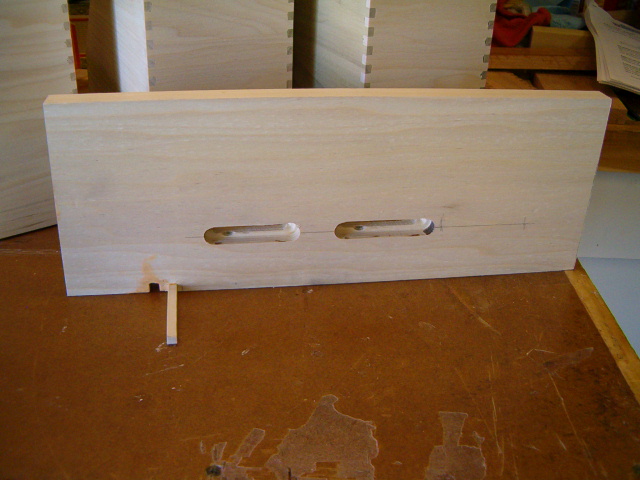

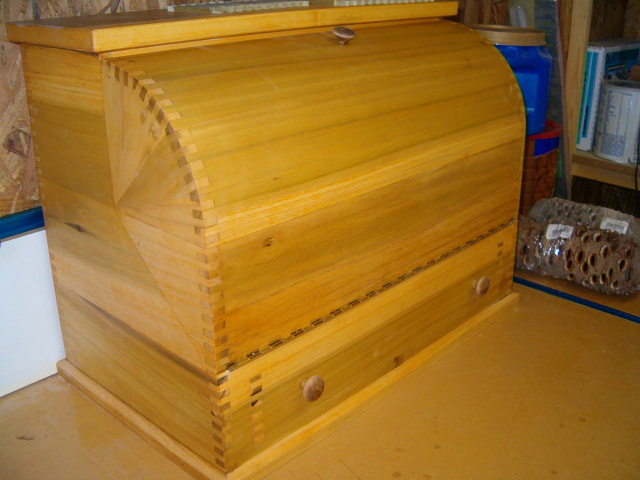

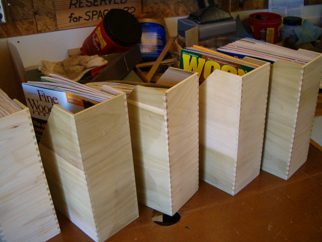

Personally, I don't measure that finely. I use a wobble dado blade set at 1/4" measured with a brass bar. The width of the fingers is the hardest to set for me. Depth is no issue, because I make the cuts deeper than 1/4", then sand off the protruding fingers.
Rather than use the quill to set the width between cuts, I have slots cut in my jig and use the handle of a big screwdriver like a hammer to tap the side of the jig to set the final distance. Trial and error.
Also, a larger number of cuts (length of the box joint) makes the set of the jig more crucial. 6" long is a snap, 12" is harder. Here's some of the results. All wood is poplar. This allows for being slightly off, as the wood can be compressed.

That must have taken some concentration to cut the box joints on the curved front on that box.charlese wrote:Hi Geo! According to Heath, the .005" work well with the wood he is using. Got to consider the species of wood and the width of the grooves/fingers.

The key to making good fitting box joints (finger joints) is precision. Once you have decided what size fingers you want (say 1/4"), select the router bit or dado blade that you intend to use and measure it. Do not assume that your 1/4" router bit will measure .25000". What ever it measures should be the basis of all else. The index pin must be the same size. The tolerance that you set at this point determines the fit for the rest of the job. Remember that inaccuracies tend to accumulate. A .005" deviate in the beginning can result in some seemingly huge gaps before you get done.eagleta2 wrote:Hi everyone.

burkhome wrote:That must have taken some concentration to cut the box joints on the curved front on that box.
No, it is very simple. Here is the trick - The box joints for the curved area are made on the bases of small triangles. The triangle's bases are about 2" each. After assembly, the curve is sanded by removing the edges of the sections.
The hardest box joints are on the back corners. About 15" tall.
