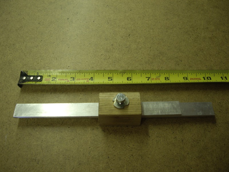

This tool is invaluable for measuring the inside dimensions.
[ATTACH]19795[/ATTACH]
The Kreg tool works fine on every brand of slide I've tried, including Blum. Not sure if it's been tried with Liberty, though. I do recall buying slides at HD. Just never looked at the brand.

Gene, I really need that tool you made to measure inside dimensions. Nicely done! Woodpeckers has "one time sales" where they make a limited run of specialty tools. A few months back it was a fancy inside measuring tool similar to yours at a fancy price. Looked really nice though.
