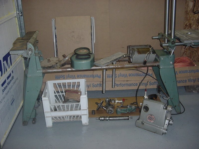

I've been a Shopsmith owner since I bought my Greenie for $50 as a basket case in an auction back in April 2004. This is what I started out with:
[ATTACH]19874[/ATTACH]

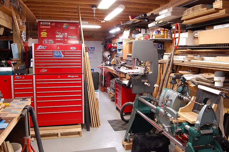

I tore it down and rebuilt it from the ground up the following winter and did a few projects with it over the next few years. Then it 2008 it became a regularly used tool in my shop as I started turning pens. It is my bandsaw for cutting the blanks, and my lathe for turning pens (over 300 to date). Here's a couple shots of the old girl in her new home.
[ATTACH]19873[/ATTACH]
[ATTACH]19872[/ATTACH]

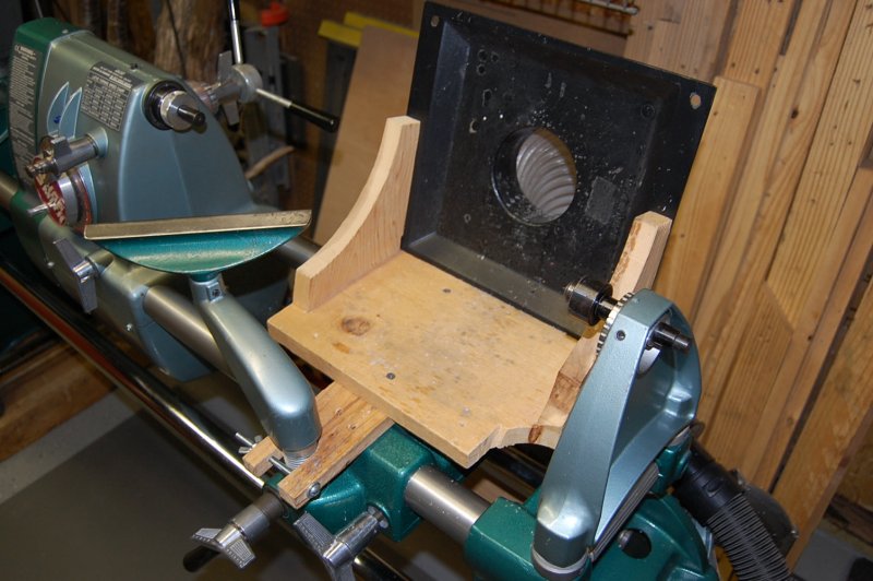

Dust/Shavings Collector 1
Post by 76winger »
The collector was cobbled together using a few scraps of cedar I had laying around from making birdhouses and a dust collection plate from Rockler intended for the bottom of a table saw. Then I used a few other pieces (also from Rockler) to reduce the 4" hole down to the size my shop vac uses.
I simply screw it onto the tool rest clamp with a couple of drywall screws.
[ATTACH]19878[/ATTACH]
[ATTACH]19879[/ATTACH]
[ATTACH]19880[/ATTACH]

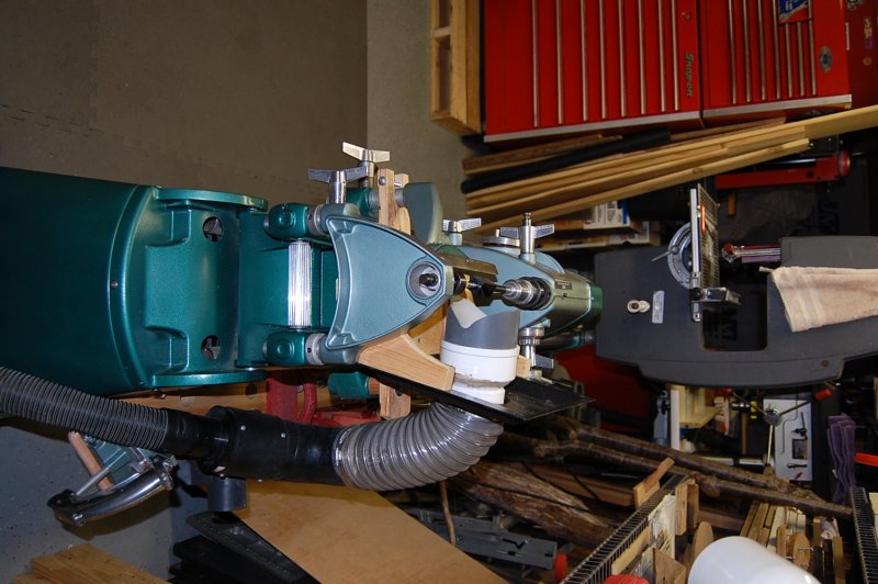

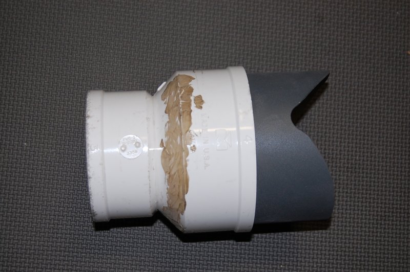

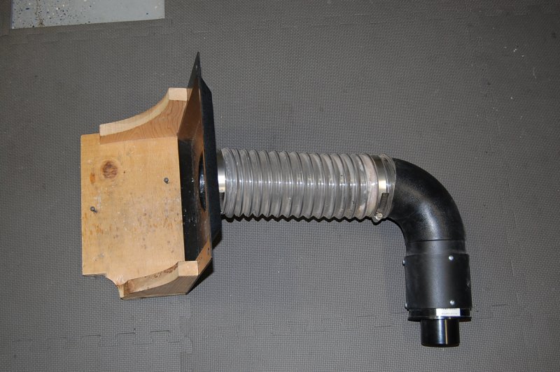

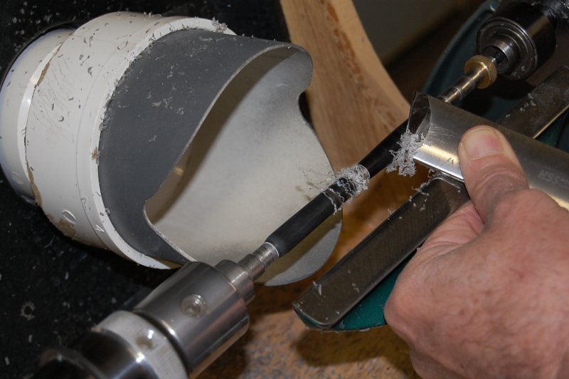

Finally, because by ShopVac doesn't have the CFM to pull the shavings really well, I came up with one more thing to get closer to the work. This came from pieces of left over plumbing vent tubes I had laying around. A reducer that "just" fits in the 4" hold of the base plat with a friction fit, and a little left-over tubing that I notched out to get close up to the work.
[ATTACH]19881[/ATTACH]
I believe the whole thing would work better with a full sized dust collector and 4" tubing, but for now it's working with what I have until the budget finds room for nicer solution.
[ATTACH]19882[/ATTACH]
Sorry #2 is sideways, the uploader didn't like the 800 pixel dimension being on the side instead of the top. Oh well... :cool:
[ATTACH]19883[/ATTACH]
Getting closer 1.jpg (71.5 KiB) Viewed 1856 times
Getting closer 2.jpg (83.74 KiB) Viewed 1858 times
Getting closer in Use.jpg (60.12 KiB) Viewed 1856 times
