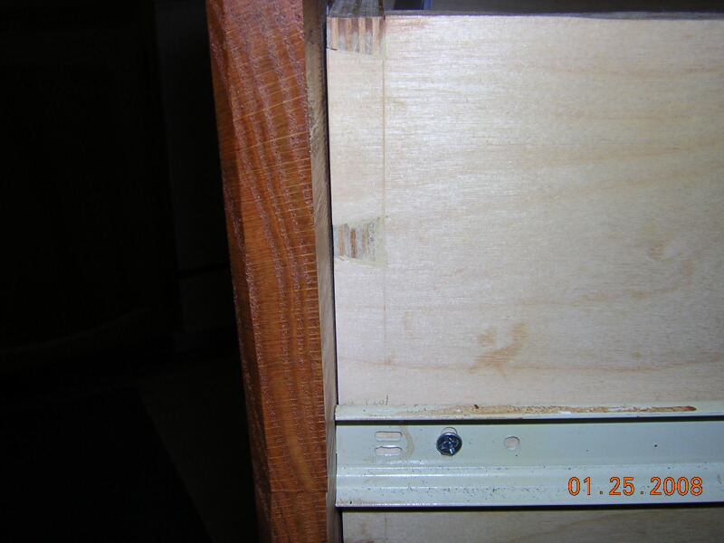

Yes, you can dovetail plywood; I've seen it done in some European furniture designs. No, it doesn't delaminate if the plywood is properly manufacted. The trick is that you need to back up the plywood with a scrap so the router bit or the saw doesn't tear out the veneer where it exits the workpiece.
The real trick is choosing the right plywood. You cannot perform an operation like this with the horse puckey they try to sell you in place of plywood in home centers. You're going to have to bite the bullet and buy some real plywood. I would recommend a "baltic birch" plywood because all the laminations are the same thickness. Because of this, the outside veneers are thicker than normal and less susceptible to tear-out.
