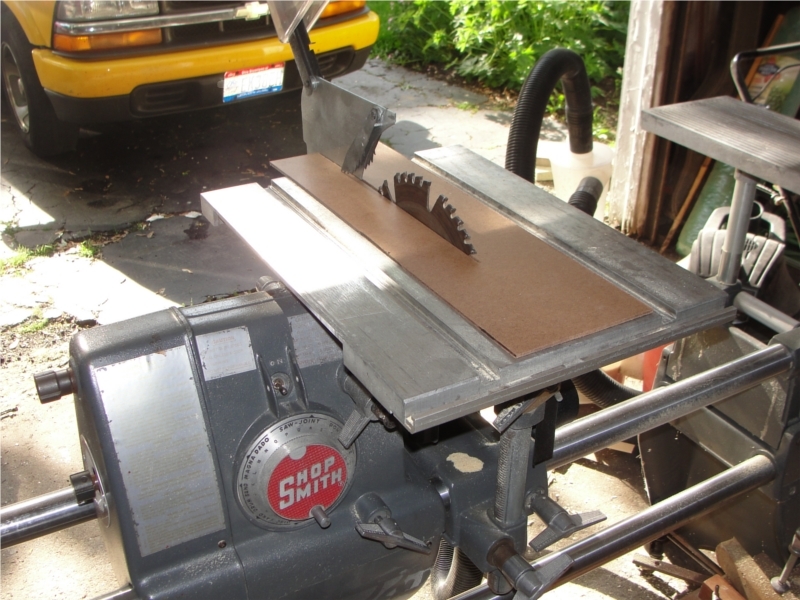

Terry,
One trick I use is this hardboard guide seen below. It's 6"x20" with a 14" cut that can be used to help set the guard/splitter quickly. Especially if you've adjusted the quill to set the blade just right.
[ATTACH]20010[/ATTACH]
Earlier versions of PTWFE had this guide in the table saw set up section.
I have "B" as well. I use a dust deputy for dust collection so I can only use one of the ports. I can't comment what two hoses can do but I would imagine that it's better then my set up. Plan "A" is an add on to the older lower guard to convert it to the newer style. The older guard also held the upper guard unlike the "B" version. This is of course for only 500 table systems. Hope that helps.
-Erich-
-Erich-

I use a straight edge on the fence side of blade to set the splitter. My issue is the crummy plastic attachment for the upper assembly. It has never been very smooth and adjusting is always a hassle. I've tried light sanding/polishing which didn't help. I've also replaced the bolt a couple of times as it gets bent easily. Straightening is a regular thing. I'm just not happy with the whole design of it. The design on the 505 and up is much better. I've been looking for 510/512 upgrade components (and the cash for that as well). In the meantime I have greatly reduced my table saw usage. The reality is I don't use my table saw much any more. Most of my ripping is now done on the bandsaw. Cross cutting is either on the bandsaw, SCMS, or my Nobex hand powered miterbox (which by far produces the smoothest most accurate cuts). Keep in mind I typically work on smaller projects. Pens, bowls boxes, etc. If I ever get started on any of the larger stuff where a table saw is the better tool I will add more energy into my search for used 510/520 upgrade components.

I had the same problem when I orginally got my Shopsmith. It came with the upper guard but the lower had gone missing. It had a gray mounting block and I couldn't even get the top guard to mount to it if I tried. I was in the market for a lower saw guard and got lucky on eBay by finding the whole package, upper and lower guards, for a good deal. I figured since my vintage table already had the block I would just swapped them and not have to worry about drilling a tapping. The new upper guard I recieved had black mounting blocks instead of gray and slid together very well. If I was to adjust the blade using the quill I can then easily slide the guard/splitter over. The orginal I couln't even put together! So maybe they (shopsmith) fixed this problem later on? I haven't bent the knob on the back of the block yet but I have said to myself that it sticks out far enough for that to happen and to keep an eye on it.
