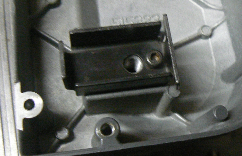

Now for some less 'simple' details. The tracking wheel and it's mount is next. The bracket is secured with a screw.
track 1.jpg (339.88 KiB) Viewed 4894 times

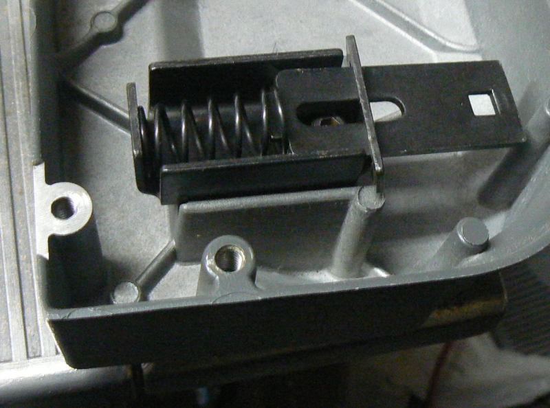

The wheel plate and spring are next. The plate slips in from the top of the bracket. The plate has a protrusion in the bottom center end that the spring nests onto. There is a bump on the bottom of the bracket for that end of the spring.
track 2.jpg (397.35 KiB) Viewed 4892 times

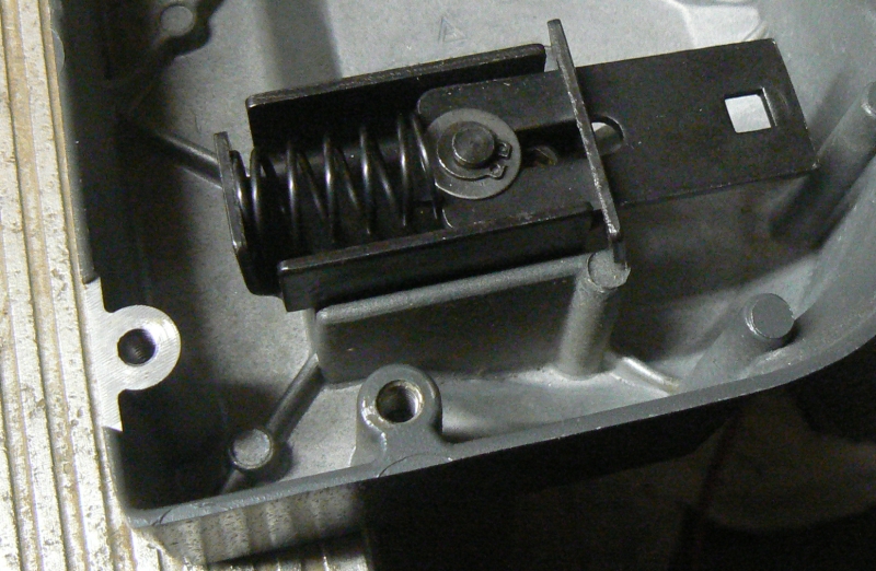

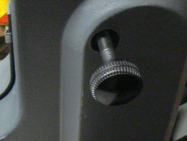

The tracking control knob is screwed in from the outside.
track 3.jpg (358.68 KiB) Viewed 4882 times

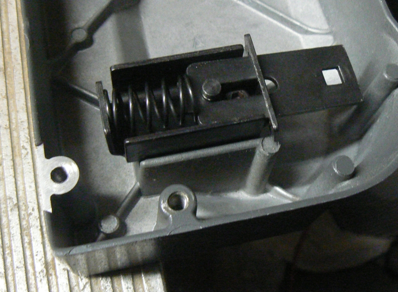

The inside end extends into a slot in the wheel plate.
track 5.jpg (391.83 KiB) Viewed 4884 times
A retaining ring and washer allows the knob to tilt the wheel plate. Getting that ring on is easier that getting it off. Make sure it seats in the groove in the control knob.
track 6.jpg (366.06 KiB) Viewed 4885 times
