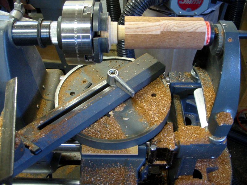

My sweet wife ordered me a lift assist for Christmas. It arrived and was installed this month. It sure does help raising the PowerPro into drill press mode.
Today, I was going to make another pepper mill and mounted the universal tool rest (UTR) and found that the base of the UTR interfered with the bolt heads holding the lift assist brackets on the way tubes. I scabbed together some spacers to raise the base up so that I could move the UTR over close to the tailstock where I needed to work.
So the lift assist and the UTR have been out there for a while, are there any other users that have both items? Anyone else have an interference problem?

Here is a picture of my setup with lifts under the UTR base to allow clearance of the lift assist. I am using a jamb chuck in conjunction with the Nova live center.damagi wrote:I haven't tried the UTR since I added my lift assist, but that's good to know. A photo or two would be great if you have them handy.

How timely. I also have the same issue with my UTR and Lift Assist. Your solution will allow me to move my headstock closer to the tailstock. Thanks for the solution.

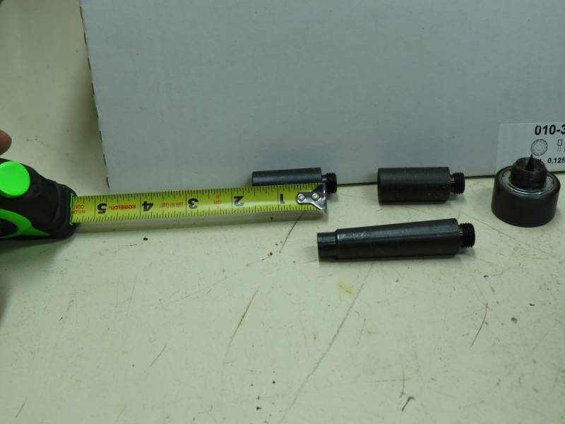

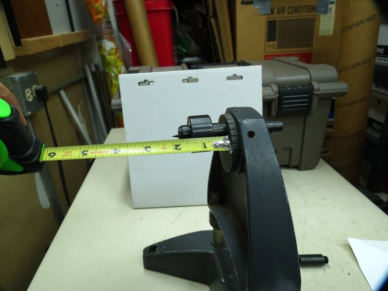

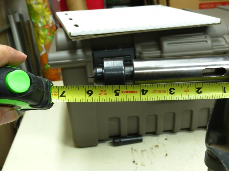

After having to deal with the evil lift assist I thought I would give a little update on making up the difference in lost movement to the right end. As was indicted here some of that can be done by a simple spacer that gets above the bolts of the lift assist.
First let's start with what you have on a typical setup. Typical being what I have. The shopsmith live center installed and measuring 2" as shown in this photo.
[ATTACH]21561[/ATTACH]

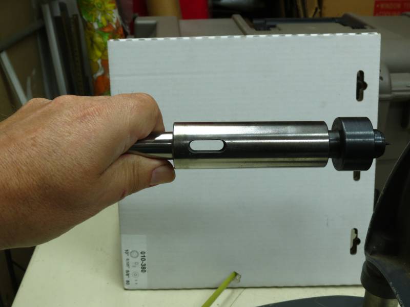

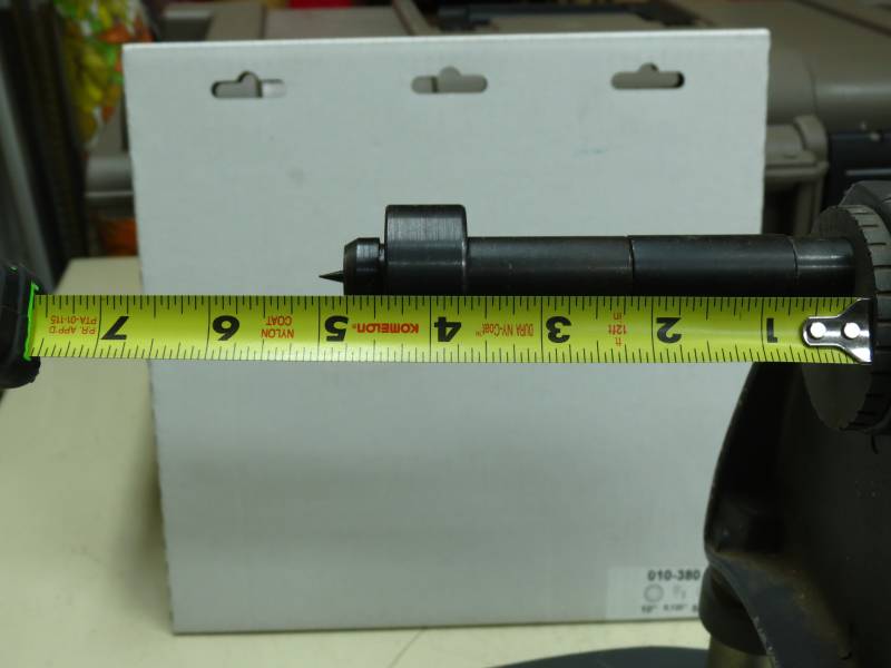

Extension options include to extend the shopsmith live center by way of the parts that originally came with the lathe duplicator. My lathe duplicator came with one and I added a second one (part number 514704). The extensions add 1-1/2" each or a total of 3". I believe I've read the limit it 2 but I can't find the information to back that up right now.
[ATTACH]21562[/ATTACH]
The result is that you are at 5" at this point. Keep in mind this is just for reference and you really can't use just the point in the real world.

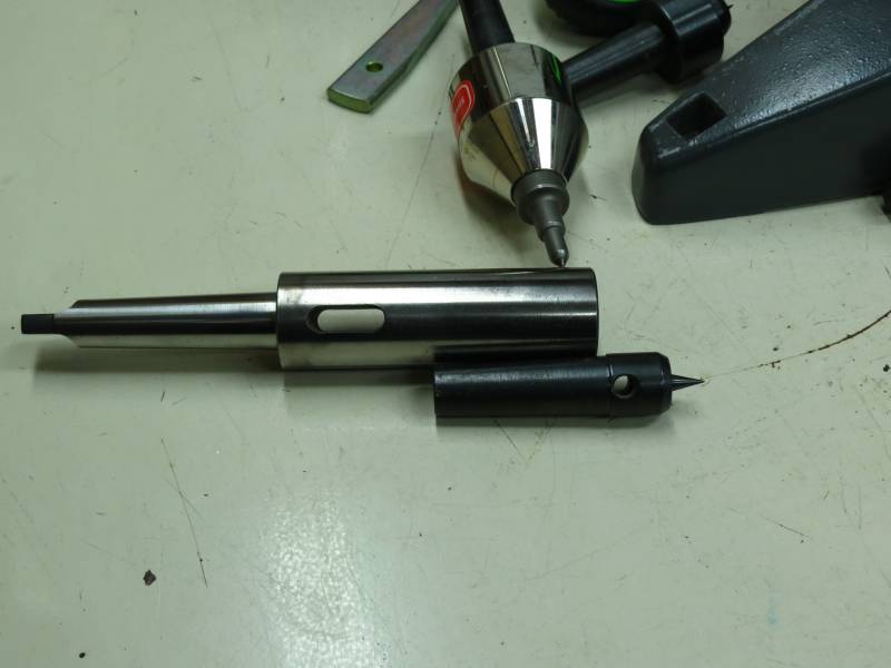

Another way to extend is by way of a MT2 extension. This basically a MT2 that fits in the tail stock and allows a live center to be installed in the other end.

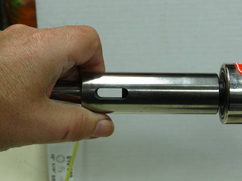

One really needs to be careful in what parts you "stick together". We are going to cover that next. Most of the extensions are designed for standard MT2 equipment that is either long enough or has a tang that aligns in the slot in the side of the adapter that helps remove the item being held. Since shopsmith parts are not built that way problems can occur. As an example if you were to use the dead center in the extension it might be in there for the ever more.
[ATTACH]21564[/ATTACH]
So if we take a look at the live center in the view window we also see nothing... meaning it too could end up as a permanent pair. (I placed it just until it started to touch and stopped, it still took some effort to pull back out.)
[ATTACH]21565[/ATTACH]
