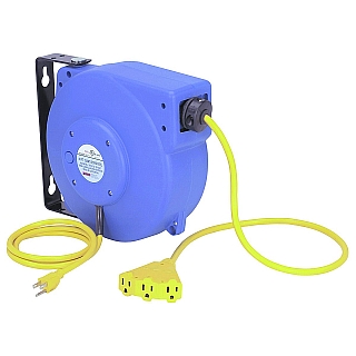

sawmill wrote:I am looking for an idea of how to add a couple of elec. plugs in my basement. I have a support beam running the full length and have some tools sitting under it. I have plugs on the post under this beam but I have to run an extension cord to use most of them in the middle. I am going to add a couple of plugs between the posts on the beam. I am thing of using a drop cord wired into the line and I would like to have more than a single plug on the end. Does anyone know if you can buy a flat plug that has a place that you can plug 2 or 3 plugs into it. I can buy an extension cord with these on them and cut them but I would like a heavier wire than these have
How about something like this from Harbor Freight?
[ATTACH]20168[/ATTACH]
- electric cord.jpg (42.8 KiB) Viewed 1748 times

Thanks for the replys. I got the job done today by using a double box with 2 plugs in it. It is all wired to my subpanel for my tools. I very seldom use more than one tool at a time but it was a pain unplugging one so I could use another only to have to plug the other one back in. I also hate extension cords and that is the reason that I added more plugs As for the harbor freight one goes thanks but no thanks I have seen the wire they use in most of there products. Thanks again for all your help on a cold and snowy day. Ivan

I don't exactly hate extension cords but I would agree that they should be used with discretion. Don't use cords that are in poor condition and don't use exceedingly long extension cords.sawmill wrote:Thanks for the replys. I got the job done today by using a double box with 2 plugs in it. It is all wired to my subpanel for my tools. I very seldom use more than one tool at a time but it was a pain unplugging one so I could use another only to have to plug the other one back in. I also hate extension cords and that is the reason that I added more plugs As for the harbor freight one goes thanks but no thanks I have seen the wire they use in most of there products. Thanks again for all your help on a cold and snowy day. Ivan
As for fearing the use of extension cords just because they came from Harbor Freight might be excessive. Pay attention to the origin of most anything you buy these days and you might find reason to believe they are of inferior quality.
Besides - are we not adequately protected by all the various consumer protection agencies that work in our behalf. Example: The cords at Harbor Freight all carry a UL approval.
