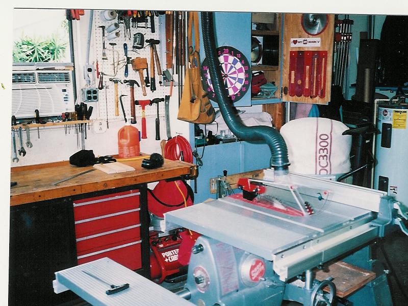

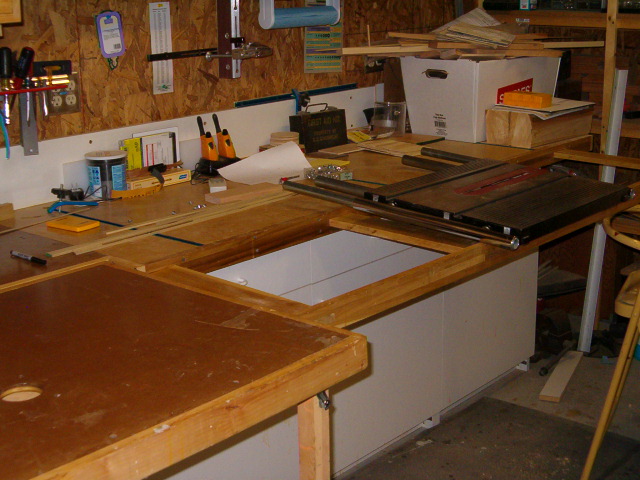

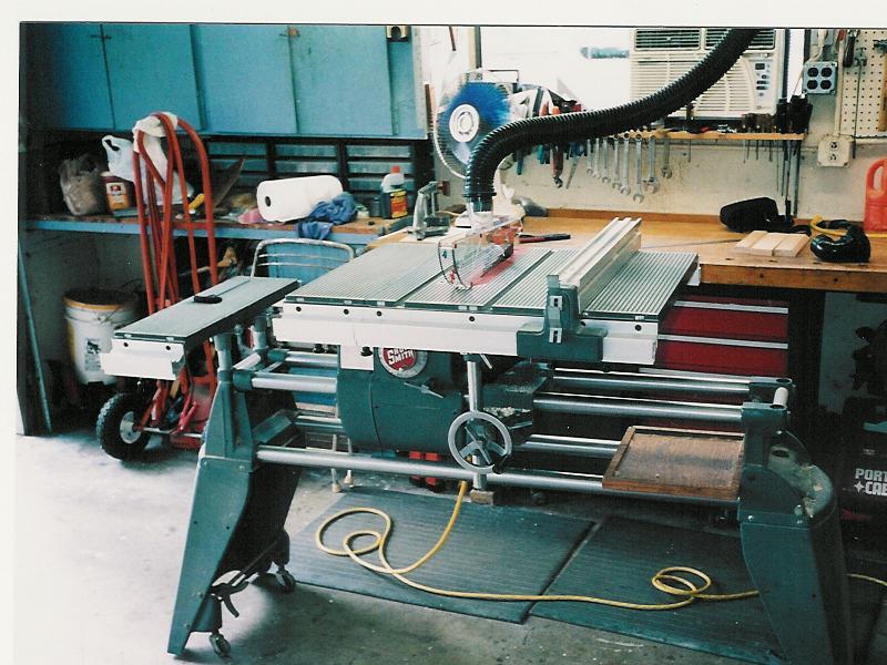

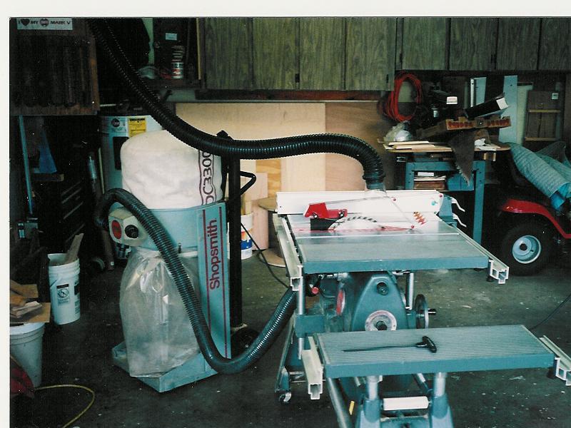

I thought perhaps some pictures may help. They aren't the best but I just happened to have them handy.
This first picture is the right edge of my bench on the north wall. My Shopsmith is setting where I park my truck
[ATTACH]852[/ATTACH]
This second picture is the left end of my bench. You see a thinner bench that runs from it to the garage door.
[ATTACH]853[/ATTACH]
Above the bench is the window and my tool ledge.
Like I said this is the north wall or side wall of my garage the east wall is the house wall and is where I store my Shopsmith, my radial arm and my lawn tactor.
[ATTACH]855[/ATTACH]
East wall Picture
I have thought of dumping the bench and move the Shopsmith under the window. I have even thought of moving the bench to sit where the Shopsmith stores. However I presently use the space behind my Shopsmith to store sheet goods
East wall Picture

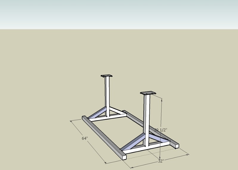

Ed, I have been wrestling with the very same problem. I am planning on building a bench using the steel shipping detail below but it needs to be movable as my work space is the same as yours. I have been toying with the idea of angle iron with a nut welded on and a threaded rod with the wheels attached at on one end. Then the rod threads through the nut and is double nutted so you can use a ratchet to raise or lower the wheels. It's all still in the concept stage so I will be interested to see if any one else has any ideas on this.

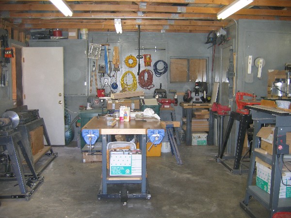

Ed,
Here are a couple of pics of the bench I built a few years ago for my shop up in the woods. It is not very tidy, but it never is. It moves fairly easy and is stable when the wheel is dropped. I have never used a real woodworkers bench as I am not a real woodworker just one that enjoys building things with my Shopsmith. I use several Zyliss vises attached to the table when working with small case work.
ldh
ldh

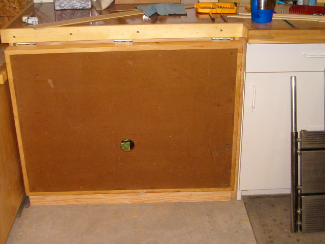

Hi Ed! Yeah here's a couple of ideas that might work for you. The first one would allow you to stay next to the wall.Ed in Tampa wrote:I looking for thoughts, suggestions, ideas.
Right now I have a wood bench that is rock steady and serves me well, but it has a major flaw it is against a wall. That means anything put on it that is wider than the bench itself hangs off the edge. Also I have to move the project around to work on the side that is facing the wall.
Ideas, thoughts, suggestions??
1) Here's my workbench. It is 25 inches wide, but expands to about 40+". In the magazine article that inspired this - the guy used kitchen wall cabinets for the base. His bench is 18" wide and expands to about 36". He was in a garage and wanted to save space. He says it will support a full sheet of plywood.
My base is three kitchen base cabinets. Gave me a little more storage and a little wider bench. I love mine! have expanded it (it just slides) to hold big pieces of a project while finishing or working on the other parts of the assembly. It will support a lot of weight! At least as much as I can lift! Projects such as]862[/ATTACH]
I have found the MDF a better surface to work on than I had imagined. I put four coats of Varathane on it prior to use. If you don't care for working on MDF, you can make the table edge and the sliding edge 1/4" taller and screw on a replaceable hardboard surface like the one on my folding router table.
[ATTACH]863[/ATTACH]
2) If I can be so bold - I'd recommend losing the solid wood doors on your cabinets and replace them with a heavy duty frame containing 1/4" peg board. This will give you storage both in and outside the cabinets.
P.S. I cut 2" off the bottom of my base cabinets so the bench top wouldn't be too high for me. You could add a couple inches if desired!
