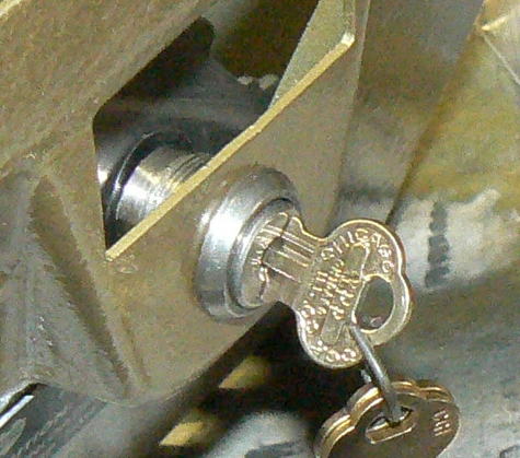

A Mark VII predates 'keypads'.]20221[/ATTACH]

ryanbp01 wrote:I never would have thought an honest to goodness key was used for the machine! I should have read whhawes' thread closer.
BPR
Not surprising unless one is familiar with the Mark VII.
The key/lock and attached plate along with an interlock in the actual switch 'shafts' prevents depressing the fwd/rev switches when the other one is already depressed. It also has a lockout position which requires the key to 'turn it on'.
The stop always 'works', but going from fwd to rev requires pushing the stop button, turning the key switch from 'forward' to 'reverse' position and then pushing the rev switch.
One would think it is idiot proof, but tain't so. If ye be fast enough, ya kin push the stop switch, move the key, then push the rev switch before the motor 'stops'. At that point it does not run in reverse!:D It runs in the forward direction.
