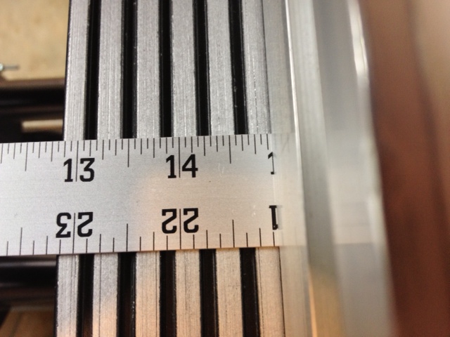

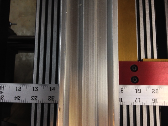

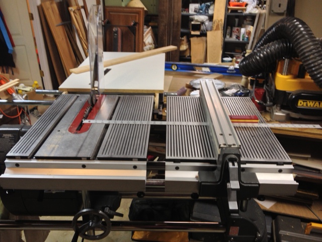

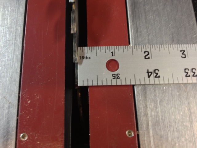

For those of you with the older 520 rails without the magnetic scales or who find using those scales too fidgity to adjust, here is my new $3, self-zeroing, 36 inch direct reading rip scale. Actually this was $2.97 at my Home Depot. http://www.homedepot.com/Tools-Hardware ... RuJdvKDmSo
Ok. This was kind of a tease. It is just a 36 inches long aluminum ruler by Empire that happens to be just thin enough to slip under the rip fence of a 520. It is calibrated to 1/16ths (close enough). Operation is simple. Slide under rip fence and put the zero end against the tooth of the blade and read distance under rip fence. Throw a square against the opposite side of the fence to keep the ruler at 90 degrees. Make sure you sight along the fence or directly overhead to avoid parallax errors.
Pictures follow:
[ATTACH]20249[/ATTACH]
[ATTACH]20250[/ATTACH]
[ATTACH]20251[/ATTACH]
[ATTACH]20252[/ATTACH]

They don't all fit under. I have an old C-Thru brand aluminum 36 inch that did not fit. The Empire just barely fits. In fact it did not fit with its protective plastic wrapper on!

Yep! When you push the end against the blade tooth, it 'self zeroes'.

If anything, I think I underadvertised this. Not only does it self-zero, it automatically self-adjusts for thin kerf blades, full kerf blades, dado blades and even quill extension!Ed in Tampa wrote:Where it the truth in advertising?![]()
