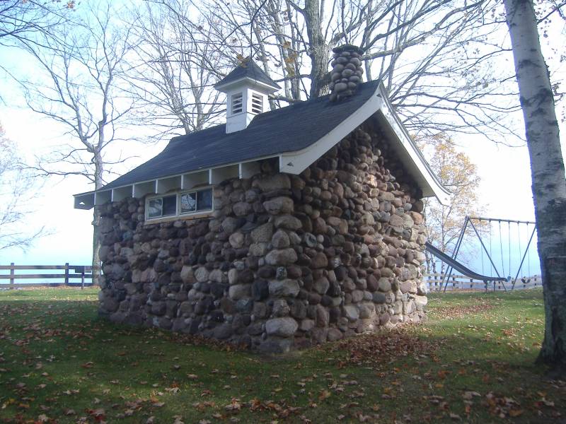

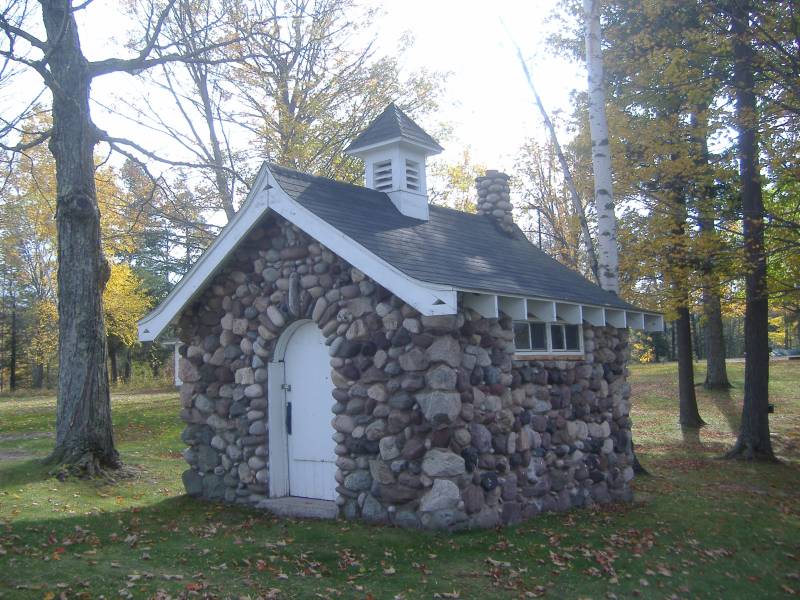

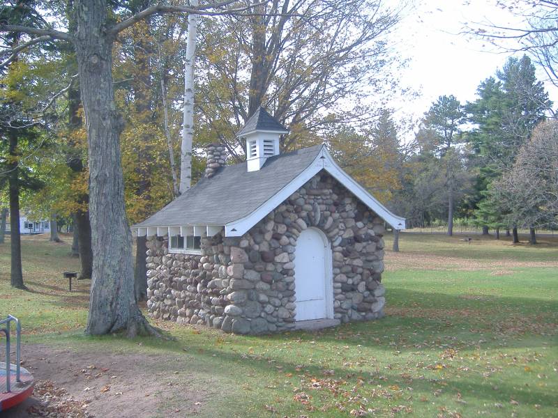

Below are some photos showing the general idea of what this will need to look like when finished.
I like the detail of the rock around the arch and frame of the door, I'd like to add that to the birdhouse if I can.
[ATTACH]20311[/ATTACH]
[ATTACH]20312[/ATTACH]
[ATTACH]20313[/ATTACH]

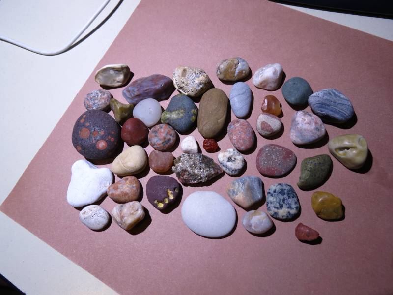

Rock thickness would be about a 1/2" to 3/4" or so. This is only a guess as to what the rocks might look like. This is part of my collection of "special" rocks that the grandkids (when they are old enough) can look at, play with use a magnify on....
[ATTACH]20314[/ATTACH]
- IMG_7284sc.jpg (56.33 KiB) Viewed 4076 times
