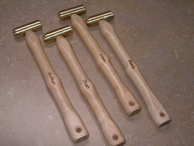

turning brass
Unfortunately, I bought hard brass and should have gotten a bar a little softer. All I could manage is making small rings (decorative) around the head and smooth and round the pein side of the hammer heads. Lathe tool was a skew. Incidentally - sawing pieces off of the bar was made easy with the lathe. Only had to move the hack saw slowly.
[ATTACH]20708[/ATTACH]
