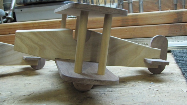

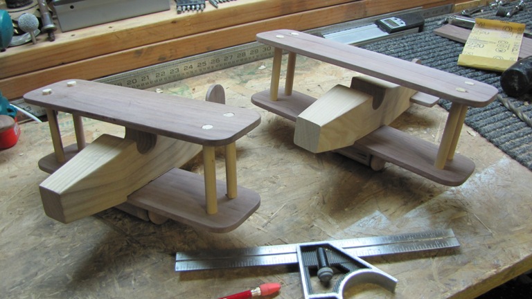

2 Grand-kids birthdays coming up. :)
So I need to glue these up and I have a few quetsions. For those of you more "well read" forum members. I WILL NOT be asking any table saw questions or asking Sawsucker for any advice.
I have Gorilla glue, thats all I've used up to this point. Undoubtably there will be some squish out and I don't want to have the glue ruin the finish process. I've heard conflicting things about, wipe with a damp cloth-don't w wipe with a damp cloth, scrape 20 minutes later, just sand ect. I ran into this with my little tool tote and the box joints. (I later saw where a box guy tapes the insides of his boxes ect and then just peels off after it dries)
Its going to be hard to get everywhere with a cloth, sandpaper or anything.
I want to learn the "right" way to handle my glue on this project and all others going forward. Finish recommendations are always welcome. Its a toy, not a work of art.
Sorry last pic is a little blurry, you get the point.

I've read or heard somewhere that once you wipe the glue with a damp rag, the glue mixes with the water and soaks into the wood. Thats why you can't just sand it off the surface afterwardds.
Is this accurate?

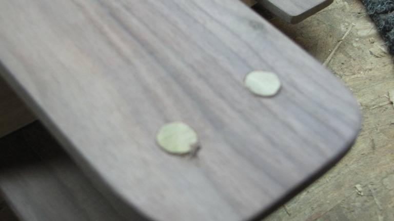

The worst place to glue will be the dowels through the wings, there won't be any way to "not" have squish-out or push-through glue..
R Hart

You can avoid some glue up mess by using masking tape. Dry fit everything together and then apply tape to those surfaces where you expect some squeeze out to occur, like on the dowels between the two wings of your airplane. After the glue dries, remove the tape and any squeeze out goes with the tape. Where you have easy access to remove the glue, like on the top of the upper wing where the dowels protrude, simply let the glue harden and then scrape away any dried glue, followed by some sanding. It's in the corners, like where the lower wing meets the fuselage, that you want some tape. Another technique is to allow the squeeze out to solidify somewhat and then use a sharp chisel to peel away the glue.
In some cases using a damp or wet rag will work, but I'd only do this with a wood like maple that has a smooth surface and not with one with a coarse grain like oak because the glue gets smeared down into the grain and would be visible when adding subsequent finishes. If you can't easily sand away any raised grain caused by the moisture, I wouldn't use a wet rag.
In the end, it's a matter of choosing which method will result in the least amount of clean-up after the glue dries.

I just read a tip in Fine Woodworking regarding glue squeeze out. Wax the outer surfaces where the squeeze out will occur when the glue that squeezed out starts to set, peel it off. It worked in the photos in the magazine.
DISCLAIMER: I have not tried this, YMMV.
Those look really nice! Forget about Sawsucker and post those to LJ when finished.
