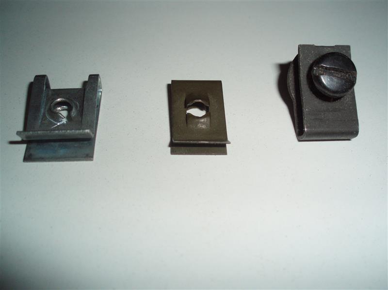

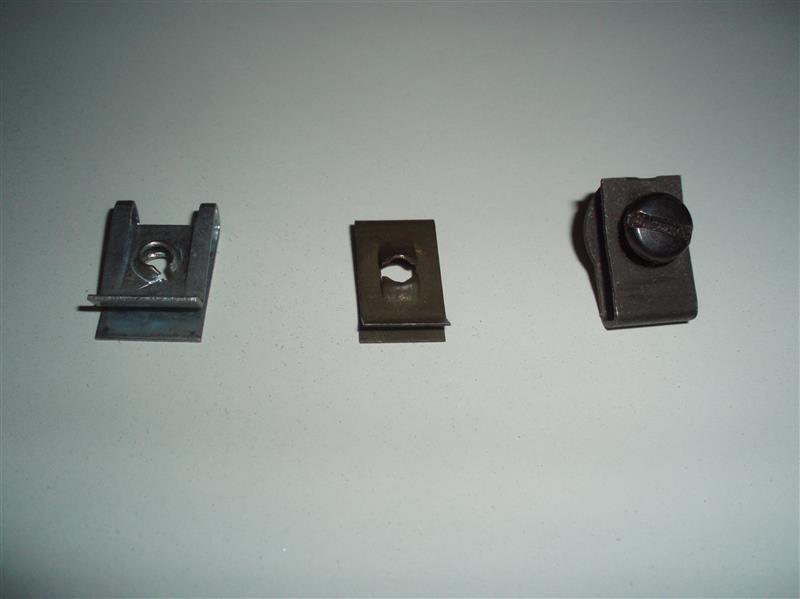

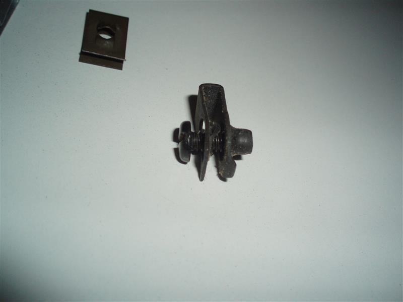

If I had your task, I would first fill in the existing holes with JBweld and then redrill as required for the tinnerman clips.
There are several different kinds of clips that could be used. I don't know if all of them go by the name tinnerman or not but they all do essentially the same thing. They replace or eliminate the need for threads in thin materials.
I would use the style shown on the right in the first two images.

Are those the SS version?
I'm thinking about those 1/4 turn fasteners as a possibility.
Please include screw size, and clip size as well.

No. These are clips in my parts bins that have been collected over the many years. The clips that are on my Mark V are like the ones shown in the center.terrydowning wrote:Are those the SS version?
The screws that are used on my Mark V are sheet metal screws (I don't know what size). The clip that I would use mate with machine screws (have a threaded receptacle).
The use of 1/4 turn panel fasteners is more work than I want. We used them a lot in airborne communications gear. They work but they are a lot of work both to install and to maintain.terrydowning wrote:Are those the SS version?

I drill the "A" heastock motor pan and belt cover holes with a #10 drill and use the tinnerman clips. The motor pan will not fit snuggly againest the headstock but is close enough.dusty wrote:If I had your task, I would first fill in the existing holes with JBweld and then redrill as required for the tinnerman clips.

I drill the "A" heastock motor pan and belt cover holes with a #12 drill and use the tinnerman clips. The motor pan will not fit snuggly againest the headstock but is close enough. I use #10 SS screws on all headstocks.dusty wrote:If I had your task, I would first fill in the existing holes with JBweld and then redrill as required for the tinnerman clips.
