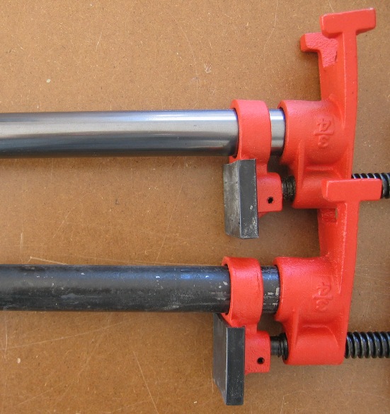

For my current project, I purchased some additional pipe clamps and black iron pipe. I had read somewhere that the black paint on the pipes can be problematic so I thought I'd try removing the paint on one of them. I found some citrus based paint stripper I had lying around and gave it a go. Wow! The pipe under that paint is really nice! Smooth and shiny. Has anyone else done this? Is there a reason not to do the rest of my pipes? I was thinking that a coat of JPW or Penetrol would be good as a rust inhibitor.
[ATTACH]20807[/ATTACH]

Careful not to make those pipes too slick or the tail portion will move on you. My pipe clamps use galvanized pipe. Always has been I think it's what my Dad had lying around. Been using these clamps my whole life.

I agree - I always used galvanized pipe and I felt it gripped the clamps better and minimized slippage.terrydowning wrote:Careful not to make those pipes too slick or the tail portion will move on you. My pipe clamps use galvanized pipe. Always has been I think it's what my Dad had lying around. Been using these clamps my whole life.

I too thought that may be a problem but my testing showed that these clamps held tight with much more clamping pressure than I normally use.terrydowning wrote:Careful not to make those pipes too slick or the tail portion will move on you. My pipe clamps use galvanized pipe. Always has been I think it's what my Dad had lying around. Been using these clamps my whole life.

Wow indeed! I really need some more clamps, but have been vascillating between expensive bar clamps and cheaper, but more pedestrian pipe clamps. Pipe clamps are looking real good now. What's the citrus paint stripper that you used on the pipes?mountainbreeze wrote:For my current project, I purchased some additional pipe clamps and black iron pipe. I had read somewhere that the black paint on the pipes can be problematic so I thought I'd try removing the paint on one of them. I found some citrus based paint stripper I had lying around and gave it a go. Wow! The pipe under that paint is really nice! Smooth and shiny. Has anyone else done this? Is there a reason not to do the rest of my pipes? I was thinking that a coat of JPW or Penetrol would be good as a rust inhibitor.
