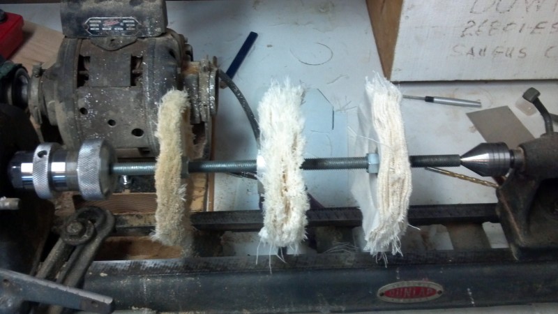

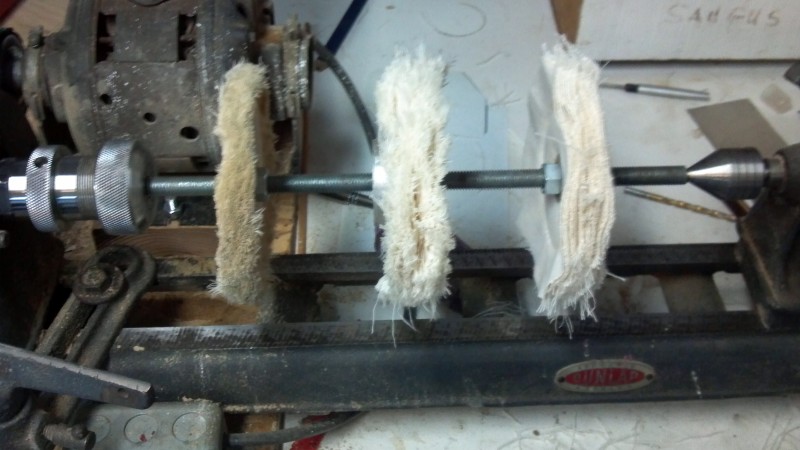

Triple Buff and SS Arbors
Here are photos of my triple Buff currently mounted on my 1939 Dunlap Lathe, but could easily be mounted on my SS.
I have not added the PVC spacers yet.
Wheels and Compounds used Left to right
Stitched cotton - Tripoli
Loose Cotton - White Diamond
Loose Cotton - I will use a blue plastic polishing compound. I have not yet added any to this wheel.

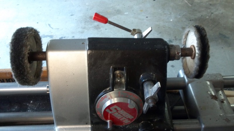

Here are some shots of metal buffing wheels. on SS 1/2 inch arbors attached to my SS.
Left wheel uses a heavy cutting compound for scratch removal on Iron and steel, right wheel uses Tripoli
[ATTACH]20882[/ATTACH]

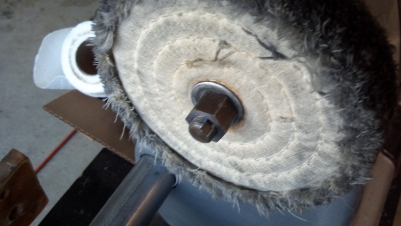

Here is a close up of the arbor, notice the groove in the threaded portion and the fine threads. The washer has a tab that matches the groove to keep it from spinning.
[ATTACH]20883[/ATTACH]
[ATTACH]20880[/ATTACH][ATTACH]20881[/ATTACH]
