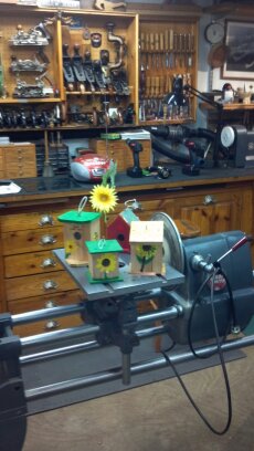

Well in North Dakota we are having a long drawn out Winter, Spring yet to arrive. My thoughts turned to Spring and the left over ceder I had from my backyard fence project last summer (33 new posts with assorted gates).
Here is a picture of bird houses just completed. I used 2x4 ceder cuttings to create the sides, hollowing them on one side. One of these I used the table saw to cove the hollow, on the others a carriage maker's plane, which was more fun than the table saw. Then you rip a 1/2" strip off the side of another 2x4 (about 6 inches long) and glue (outdoor yellow glue) the strip between the coved end pieces. Drill a 1-1/4 inch hole in one of the strips, mount your removable roof and put on a bottom and that is it. I also exercised my artist side by painting them up. At least I don't have to burn that nice ceder and it will help the critters too.

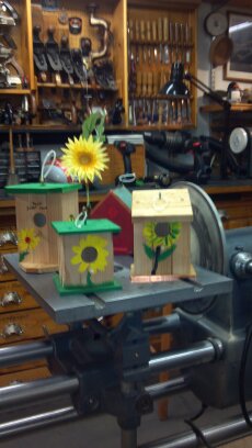

[ATTACH]20842[/ATTACH]
Here is a better shot.

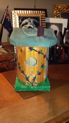

[ATTACH]20843[/ATTACH]
This bird house is a decagon (10 sided). I cut the ceder into 1-1/2" strips about 1/2 inch thick. Cut the strips with an 18 degree bevel on each side. Ten strips closes the circle. The strips are 6 inches long. I cut the tube after glue-up on the top with a 10 degree bevel (on the band saw) so the roof sheds rain.

We could spend a day or more just looking at planes and chisels!:Deagleta2 wrote:Nicely done birdhouses!
As the more seasoned users here have taught me, I like to look beyond the subject in the picture and notice some things in the background.
Your shop looks great! How about a virtual tour?![]()
Thanks
Geo
I'll see what I can work up. I'm still mystified by the picture post, as I haven't figured out how to post more than 1 pic/message and I can't get the upload paper clip on my mainframe, but do on my laptop. I don't have a web page or URL. I guess I am showing my ignorance about some of the ways of the little electrons:eek:
