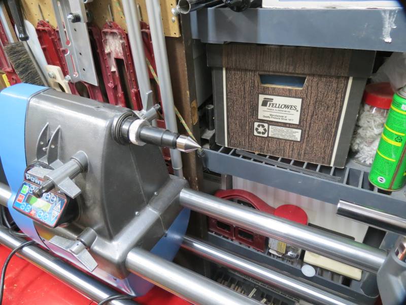

Here is a picture of it mounted in a drill chuck.
[ATTACH]21007[/ATTACH]

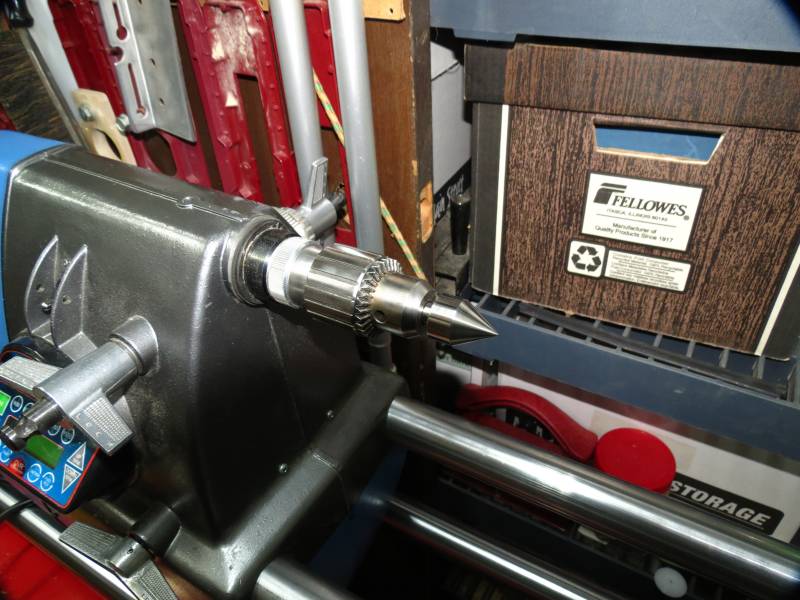

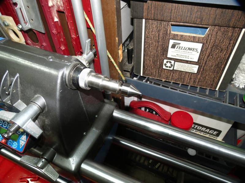

I have two different style router chucks so the next two pictures show them with the center mounted.
[ATTACH]21008[/ATTACH]
[ATTACH]21009[/ATTACH]

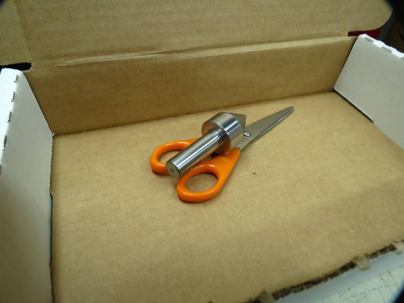

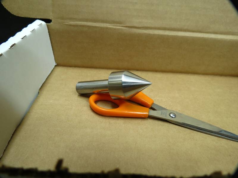

This is close up showing the center. The larger dia. is 1", that portion is 1/2" long before it gets to the 60 degree taper. The mounting area is 1-1/2" long.
[ATTACH]21010[/ATTACH]
The mounting area is not tapered, it is simply a 1/2" dia. round.
[ATTACH]21011[/ATTACH]
This one was custom built for me using dimensions I provide. I'm impressed with the work that was done. While I have no long term experience with this item I will say first impressions count a good deal with me and I'm impressed.
