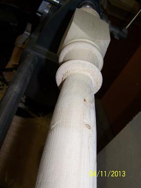

I am currently trying to turn newell posts to finish a pine staircase I built. Not enough capacity on shopsmith to turn in one piece so I am turning a tenon on one end to be attached to square base. Problem is in order to hold the chisels low enough to get shearing action I am in a very uncomfortable stooping position making control a major problem. Anyone else delt with this. Thought about building a platform to set the shopsmith on. Put the project on hold till I can solve the problem.

The 'problem' as I see it is the need to get close to the tenon, but the larger girth of the post will not allow that with an 8" tool rest.
Brain storming for sure, but could you get a shorter tool rest closer with the help of also extending the quill(or does length prevent that?)?

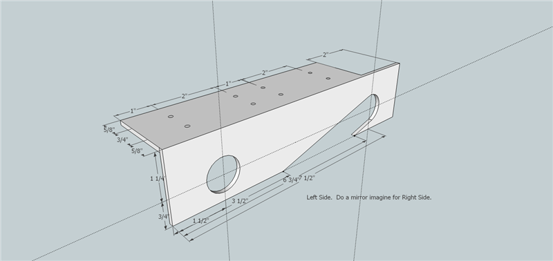

I remember seeing plans for a work bench that utilized scissor jacks and used a battery operated drill to raise and lower. Seems like he had it set up so that you raised and lowered both legs from one bolt on one end. That set up would be ideal. I am 5'6" and the table saw is about an inch too high for my liking. I have had my SS since 1984 and am just now getting to type where I feel like I can spend the majority of the limited shop time I have doing shop upgrades rather than working on projects, hence all my questions on adding an OFT to my SS. Which, BTW, I ordered the final two pieces I needed to move forward on that project. I am going for the angled support version with a lot of Dusty ideas plagiarized but with some different materials. One of the driving factors on my OFT is convenience and the SS brackets would just hinder usage as it would require too much time to install and take off and no convenient way to get it out of the way without removing it. The hook shaped brackets that Dusty made out of aluminum angle is the ticket. Dusty, would you direct me to where you posted the sketchup rendering with measurements that you uploaded at the forum please?dusty wrote:Raise or Lower the Shopsmith to position it where you are comfortable.

claimdude wrote:I remember seeing plans for a work bench that utilized scissor jacks and used a battery operated drill to raise and lower. Seems like he had it set up so that you raised and lowered both legs from one bolt on one end. That set up would be ideal. I am 5'6" and the table saw is about an inch too high for my liking. I have had my SS since 1984 and am just now getting to type where I feel like I can spend the majority of the limited shop time I have doing shop upgrades rather than working on projects, hence all my questions on adding an OFT to my SS. Which, BTW, I ordered the final two pieces I needed to move forward on that project. I am going for the angled support version with a lot of Dusty ideas plagiarized but with some different materials. One of the driving factors on my OFT is convenience and the SS brackets would just hinder usage as it would require too much time to install and take off and no convenient way to get it out of the way without removing it. The hook shaped brackets that Dusty made out of aluminum angle is the ticket. Dusty, would you direct me to where you posted the sketchup rendering with measurements that you uploaded at the forum please?
Thanks Dusty!
Here it is. The only measurement that are critical is the size and separation of the two holes for the extension tubes. You will need to do some customizing (rounding off of corners, etc) to achieve form/fit. This is not a one item fits all design.
[ATTACH]21184[/ATTACH]
Word of Caution:
If you are going to utilize a diagonal support, there is one CRITICAL measurement -- the pivot line from the Main Table. The top end of that diagonal support must be located so that the end of that support is located in the same vertical and horizontal plane as the trunnion pivots. The slightest deviation will cause the OFT to depart from its' intended plane when you tilt the table.
If you get it right, the OFT and the Main Table will remain in the same plane throughout a tilt maneuver. I "finally" got it right.
Anyone building something like this needs to move slow and deliberately throughout the process. For example: when done, you want the OFT to be just a little bit below the main table height. This prevents the work piece from snagging the edge of the table as it passes from main table to the OFT. The thickness the OFT itself then becomes critical and cannot be predetermined UNLESS the brackets are precise.
