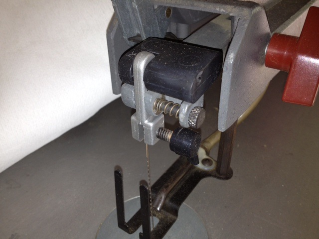

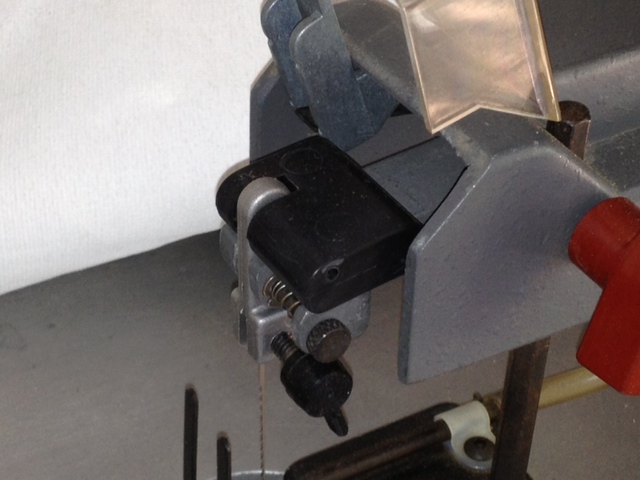

Has anybody completed the upgrade to the "old gray" version part number 550220 scroll saw to use the new quick disconnects and clear plastic cover? I can't figure out how the one blade block with the black plastic piece is suppose to mount to the end of the arm. If I remove the plastic piece and drill out the dia. of the hole in the block then I can mount it to the arm. I can't see any other way to do it. Help??? Everything else works like a champ on the upgrade kit.:(

Pics post upgrade...
Post by henecle »
Hope these help... did mine a few years ago when I got it off CL.
Upgrade 1.jpg (78.3 KiB) Viewed 9459 times
Upgrade 2.JPG (89.83 KiB) Viewed 9452 times

Thanks very much!!! Do you know what the purpose of the black piece is??:)

texomawood wrote:Thanks very much!!! Do you know what the purpose of the black piece is??:)
It is intended to allow for a quick release of blade tension (or tensioning of the blade). Look at henecle's pictures closely and you can see how the black piece acts as a cam.

The instructions I got from them didn't cover that portion at all and there was no photo to go from. Thanks for the info. Is there a difference in the tension that is put on by the blade holder and the tension quick release lever on the top of the parallel arms? It seems like it is a duplication.
texomawood wrote:The instructions I got from them didn't cover that portion at all and there was no photo to go from. Thanks for the info. Is there a difference in the tension that is put on by the blade holder and the tension quick release lever on the top of the parallel arms? It seems like it is a duplication.
The cam allows for the quick release and/or reapplication of tension to the blade. The know, on top of the parallel arms, is how tension is applied/adjusted.
Prior to upgrade, one had to detension using the know before the blade could be removed. After the blade was installed, the know was then used to apply and adjust tension.

Thanks Dusty. Now it makes more sense. I appreciate everyone's help. The saw works great, it was the one SPT I never had before. I was able to pick an old one up off ebay and for the cost of the upgrade kit, some wax and elbow grease I have a "like new" scroll saw.
