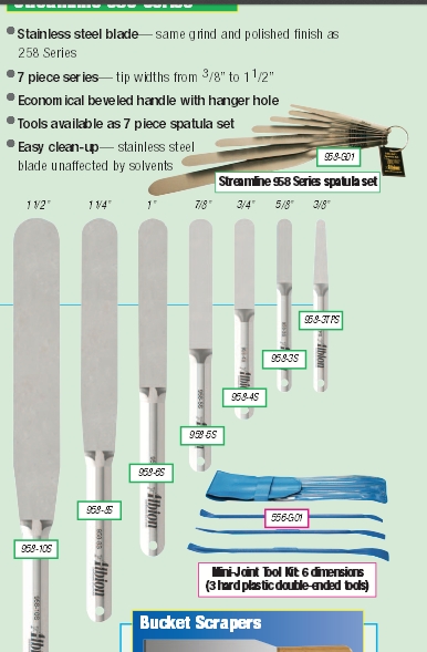

I have recently received instruction/advice from a professional caulker(crack sealer) on the how to of applying caulking. He also gave me an older set of spatulas that he had replaced with a new set.
Contrary to my previous misunderstanding
1) Fill the crack with caulking by using the 'gun' in push mode. That is, the advancing gun is pushing the caulk into the crack as it advances(not the tip as it passes over the caulk). Try to get just slightly more than the amount needed applied. The result will be varied (uneven).
2) Using a spatula(spatula defined/described below) that is sized for the 'current task' again in push mode(the round end advanced into the bead just applied) at a shallow angle. This removes excess caulking and is wiped off the spatula or allowed to roll off the sides of the spatula. This creates a straight boundary on both sides of the caulking(assuming straight sides of the surfaces being caulked but at least a consistent fill[assuming push consistent 'angle'] amount between them if not). If a vertical joint, advance from bottom to top.
3) While holding the spatula at a steeper angle but now in 'pull' mode and pressing tight to both 'sides'. dress the joint(smooth it out). There should be little to no squeeze out if steeper angle is 'proper' compared to the earlier shallow angle during excess removal. If a vertical joint, this should be advanced from the bottom towards the top.*
4) Repeat 3, but this time in the opposite direction. *The vertical joint looks better if done top to bottom last.
A spatula for this endeavor is a thin, narrow, long stainless steel 'blade' with a rounded business end. They come in different sizes for different sized joints. They are similar to a wooden popsicle stick and I have seen the popsicle sticks sold for use as caulking spatulas. I have not tried the popsicle sticks but believe they are too thick to perform step 2 effectively.
I have done these steps as described and have discovered there is still some 'skill' involved, but with not too much experience/practice very acceptable results are attainable.
Much more acceptable than previous method of applying, then smooshing with a moistened finger!]21299[/ATTACH]
I think the secret to these spatulas is the rounded end and the thinness. Any thing similarly shaped(and thin) should work. The round end is a semicircle with a 'semi' diameter equal to the width of the spatula. The sizes above are the 'blade' width.
And yes the spatulas flex while being used. That makes them controlling the 'tension'.
- albion.jpg (120.81 KiB) Viewed 1124 times
