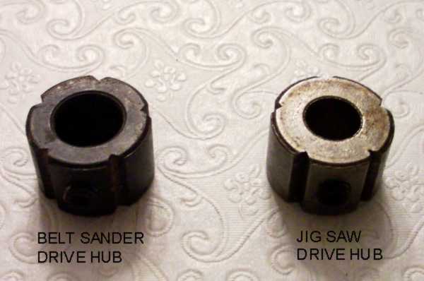

By bizarre coincidence, I bought a Speed Reducer on eBay a couple days after wannabewoodworker sold his. And it came without the "Drive Hub", ShopSmith part # 503740. I suspect that this may be the part in question here -- the male hub that goes on the spindle -- not a female-female coupler. Same as the one identified below as the "belt sander drive hub". According to the manual, it is included with the speed reducer, and is required in order to use the reducer either in spindle-mount mode or band-saw drive mode.
[ATTACH]21342[/ATTACH]
So I emailed the seller and asked if he still had it. If not, no problem, SS sells them for $3.50. I just wasn't too excited about a potential backorder and/or large shipping charge from the mother ship.

- drive hubs.JPG (21.37 KiB) Viewed 2973 times
The allen head cap screw is 10-24 x 1-12" long. There is also a lock washer that goes underneath the screw head.wannabewoodworker wrote:So I sold my speed reducer on Ebay as I needed some extra money and it wasn't being used. I bought it used and it did not come with any couplers. So that is the way I sold it with pics to show what the buyer would receive. So now he is requesting that I send him a coupler? I am going to send him one of my couplers in the interest of keeping the peace but in the future I am gong to have be very precise and blunt about what is included in the sale of anything I guess. I have a 100% feedback rating that i have worked hard for and don't want someone messing that up due to a crummy coupler.....sheesh!
Anyway it also seems that the allen screw for the coupling to the headstock mysteriously went missing and I am being tapped to supply one of those as well. Does anyone know what size that allen head cap screw is so I can go to the local Lowes and grab one?

It appears we(some of us) were on the wrong page.
Seems the set screw is a retaining screw and the coupler is a hub.
Gotta agree if that is accurate, the buyer has a point!;)
