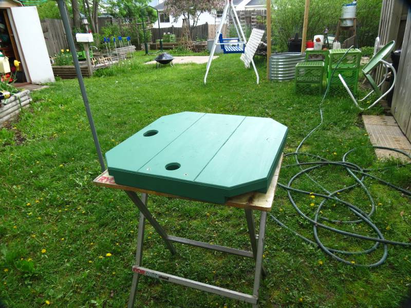

I didn't take any photos during the build but this was done as a construction project, circular saw, jig saw, that sort of tools. However the biscuits were were done on the shopsmith. This picture is a top view, and as you can see it is painted and ready for put'in together.

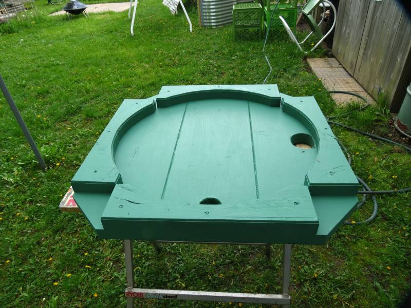

When flipped over you can see the curved parts (done with shopsmith bandsaw). If you ever decide to build one of these and want a good fit on the barrel top you have to index the barrel and trace the curves to match. They all seem to have some what of a unique "circle". I use the pump hole to match the mark I put on the drum.

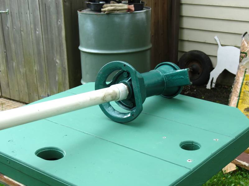

Next you can see the cistern pump with PVC pipe attached. In my early years we had a cistern pump in our kitchen, that is how we got water for everything. The pump hole in the top allows for a snug fit of the coupling so the pump can be installed with the pipe parts in place.
[ATTACH]21375[/ATTACH]
The pump is "centered" by the pipe, the holes of the lag bolts are then located and drilled. The two side holes go in to the doubled thickness wood but the back one is in only a single layer.
[ATTACH]21376[/ATTACH]

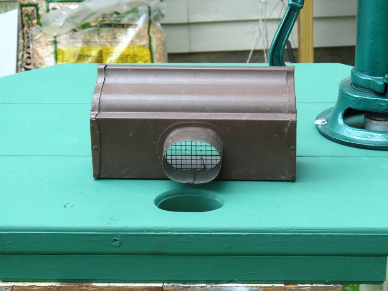

The inlet is a section of gutter with end caps added, it calls for an "oval" hole. Again a snug fits is desired. You can see the larger catch screen for larger bits, a second (not in place yet) window screen is used for smaller bit and to keep the bugs out.

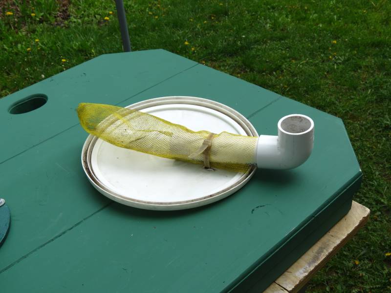

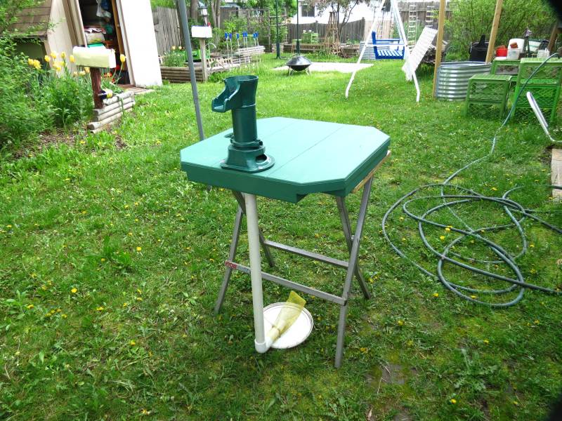

The next part is the filter and suction area that goes on the bottom of the pipe near the bottom of the barrel. You don't want to suck up any thing to large and you don't want the gook the ends up on the bottom after a few months so this keeps everything they way it should be. BTW there is a major amount of suction so this also keeps the liner from being sucked up.
[ATTACH]21378[/ATTACH]
The next picture shows how the parts fit together. This is also where you need to check the length of the pipe to make sure it is not too long, you want it at the bottom but not actually hitting the bottom.
[ATTACH]21379[/ATTACH]

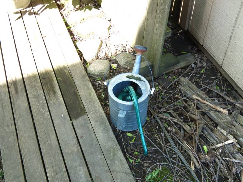

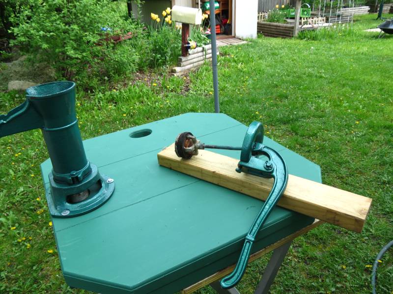

The pump got a coat of fresh paint for this year service. The leather (black part on the piston) drys out and will not seal well, actually they also wear out but I hope to get at least another season out of this one.
[ATTACH]21380[/ATTACH]
One easy way to get the seal back is to soak in water, as shown here in watering can. It takes a while so it is still soaking now.
[ATTACH]21381[/ATTACH]

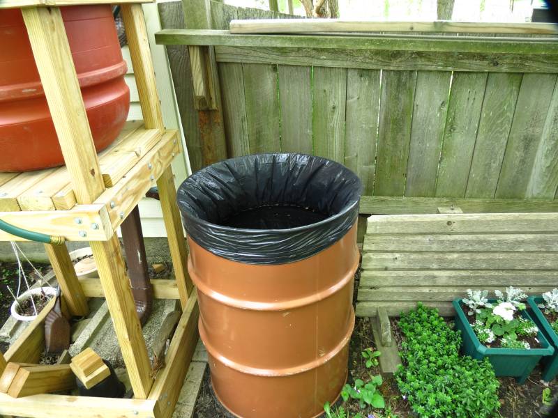

The barrel is a 55 gallon drum. I line it so it is easy to clean out in the fall, you pull out the bag and fill with garbage and away it goes....
[ATTACH]21382[/ATTACH]

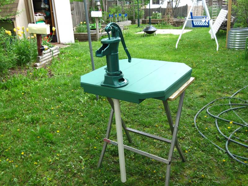

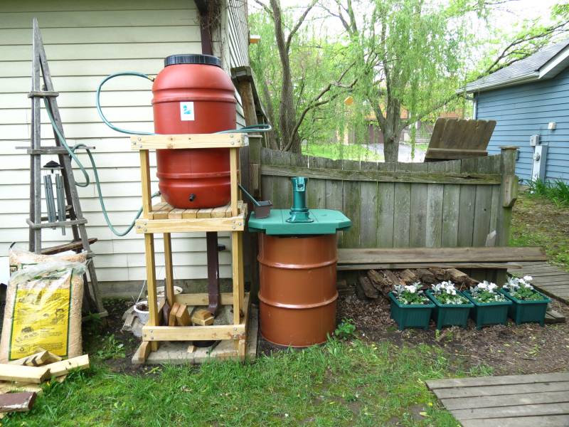

The top is then placed over the drum and there you have it.
For now this drum is set up as an over flow for the other rain barrel. Later I intend give it a source directly off the roof, just no time for that now.
[ATTACH]21383[/ATTACH]
We now have 145 gallons of rain water capacity. Back to what I had last year. I was hoping for this to be an addition rather the a replacement but that is not how it worked out.
